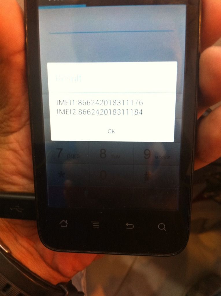

<article>
tools:
AIO FLASHER
Firmware:
S100 Firmware
Usb driver
Procedure:
need to fastboot first
Press volume + and power together until the green screen will appear
launch AIO flasher and select and flash 1by1 boot.recovery,system
Done:
</article>
