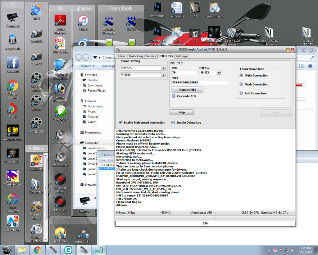

SHARE KO LANG PO LOGO HANG AFTER FLASH BLANK IMEI NA
AYAW MA ROOT
TRY IBA'T IBANG ROOT , NAGAWA NA LAHAT NG PARAAN SAPARA MAROOT AYAW TALAGA!!!
TRY SA CM2
TRY SA MIRACLE CRACK AYAW MATIGAS TALAGA
NAISIP KO NCK CRACK
OPEN NCK SET TO MT6580
CLICK IMEI UTILITIES
CLICK IMEI 1 PASTE OR COPY YONG NASALIKOD NG PHONE
CLICK REPAIR THEN SALPAK NG USB PRESS AND HOLD VOLUME UP.
WAIT LALABAS SUCESS
SAME PROCEDURE PARA SA IMEI 2 NAMAN
COPY ULET IMEI
CLICK REPAIR THEN SALPAK USB PRESHH OLD VOLUME UP !!
DONE !!!!
