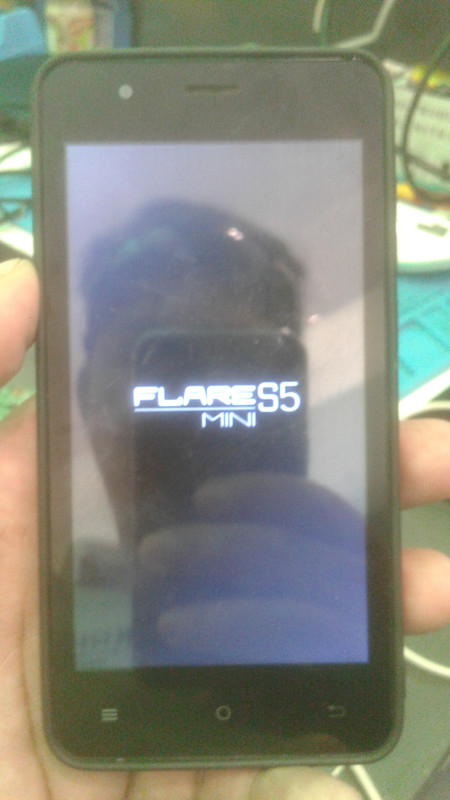

for reference flare s5 mini hang up

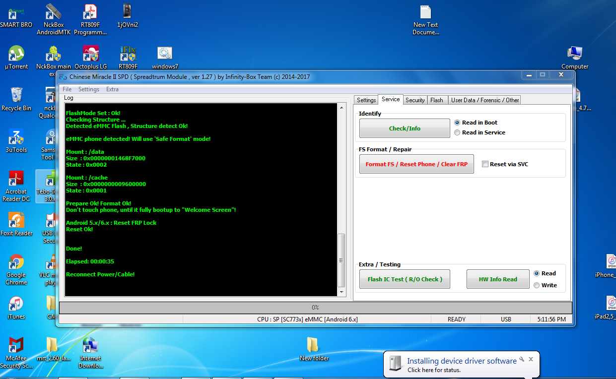

open CM2SPD
Goto setting select
SP [SC773x] eMMC [Android 6.x]
nxt goto service click format fs/ reset phone/clear frp
Remove battery. Insert battery back
Press and hold 'VolumeUp' and 'VolumeDown' keys
Alternative : just ONE 'VolumeUp' or 'VolumeDown' key
Insert cable
srceen shot
logs..
Card found: S/N : A2712ED6 , v0136
Chinese Miracle II [SPD module] v 1.27
1. Remove battery. Insert battery back
2. Press and hold 'VolumeUp' and 'VolumeDown' keys
-> Alternative : just ONE 'VolumeUp' or 'VolumeDown' key
3. Insert cable
==== Wait for phone...
Phone found! [ 21 ]
Port Opened
Sync...
InitBoot Done [ 0x81 ] , Ver : SPRD3
Sync...
Sending FDL
[Info] : If SW freeze here more, than 15 seconds - remove cable
FDL Ready!
Boot Ver : SC7731 Crev eMMC Loader v2.0
Sending FLASH FDL
FLASH FDL Ready!
Boot Ok!
FlashMode Set : Ok!
Checking Structure ...
Detected eMMC Flash , Structure detect Ok!
eMMC phone detected! Will use 'Safe Format' mode!
Mount : /data
State : 0x0002
Mount : /cache
State : 0x0001
Prepare Ok! Format Ok!

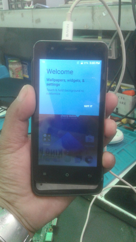

Don't touch phone, until it fully bootup to "Welcome Screen"!
Android 5.x/6.x : Reset FRP Lock
Reset Ok!
Done!
Elapsed: 00:00:35
Reconnect Power/Cable!
