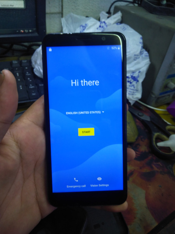

Baka may magawi mga sir
Flare S7 prime FRP
>>>HERE<<<

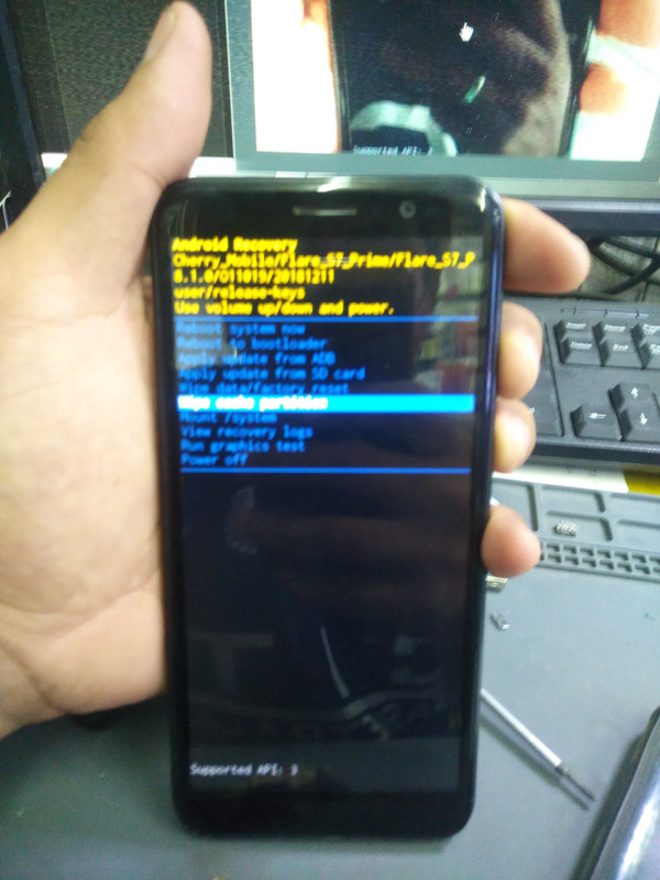

1st hard Reset muna
Press Power 1st then Volume up for couple of seconds
2nd Pag FRP na

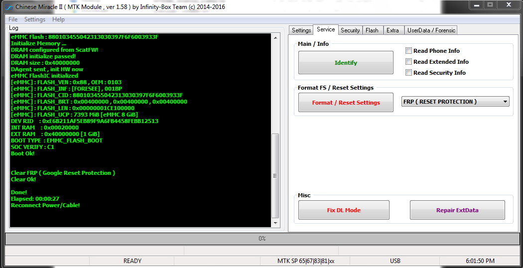

Open Cm2Mtk Input scatter boot file then Go to service and find Reset FRP
(Boot Vol + and -)
Sana po makatulong

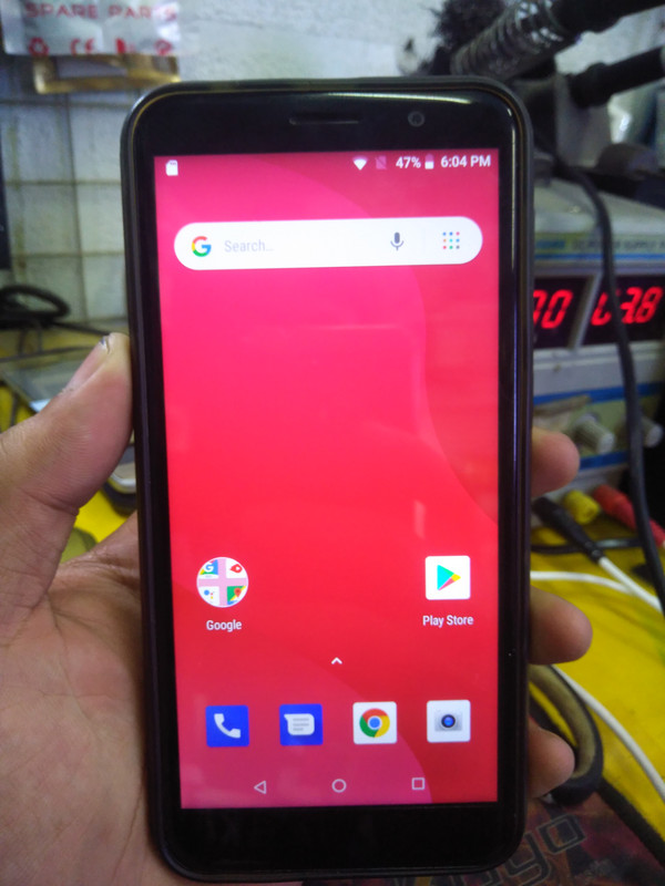

Salamat dito TS, fully working, additional info ko lang para sa lahat kasi may ibang procedures or process sa mtk wether flashing or frp or unlocking na di na kailangan ipress and hold ang boot key dahil detected naman sya, pero sa method po na ito para successful need ipress and hold ang boot key which is volume down. Salamat po at sana makadagdag tulong din, pumalpak kasi several tries ko nito sa iba ibang tut nun pala need ipress boot key para success. Salamat ulit TS!!! Good job :)
