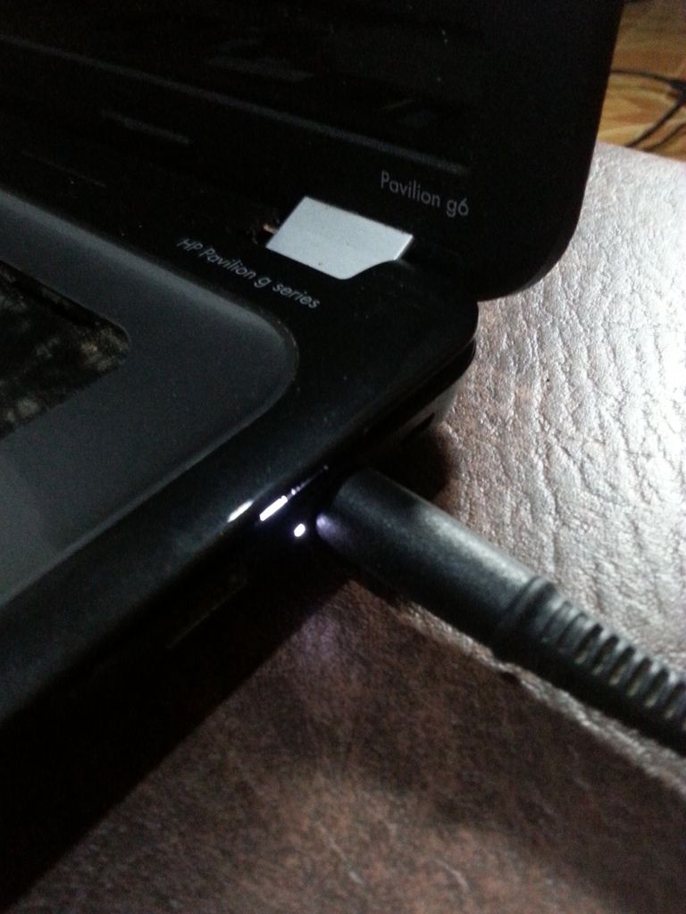

* problem; blinking ang lights sa charging port nya, no power/blackscreen
pag e charge mga boss blink-blink lang...

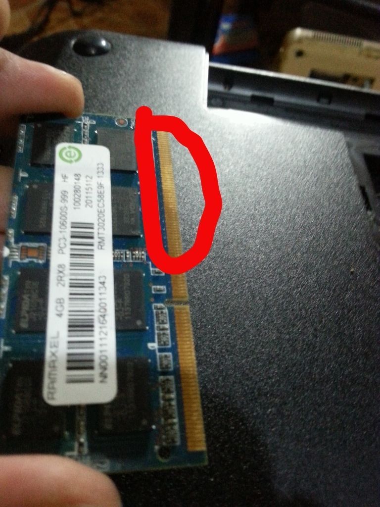

una ginawa ko; may na pansin ko sa memory, linis nang tinir at eraser
no luck

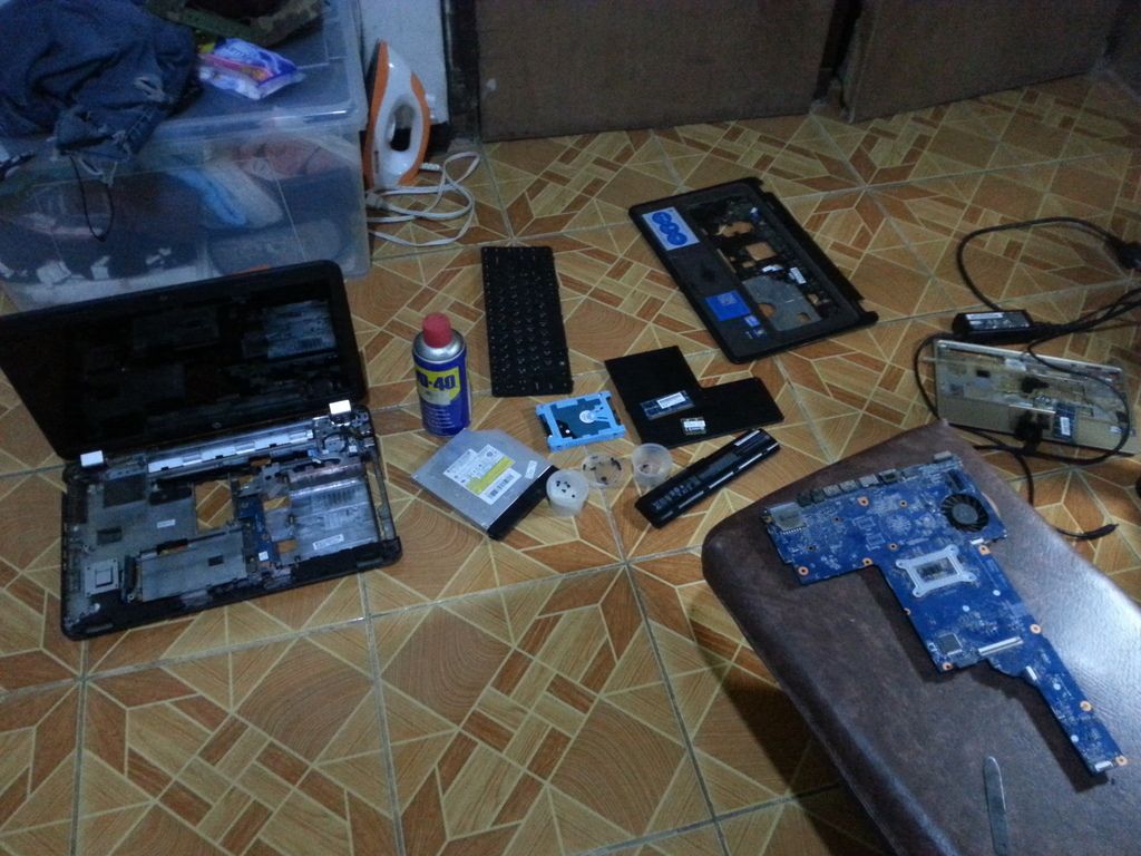

proceed sa baklas; "wish me luck"

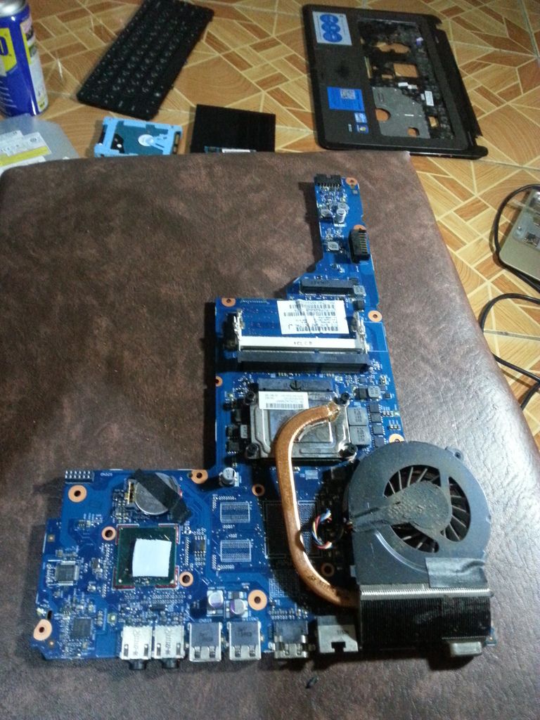

remove processor at cleaning pati motherboard, "general cleaning"

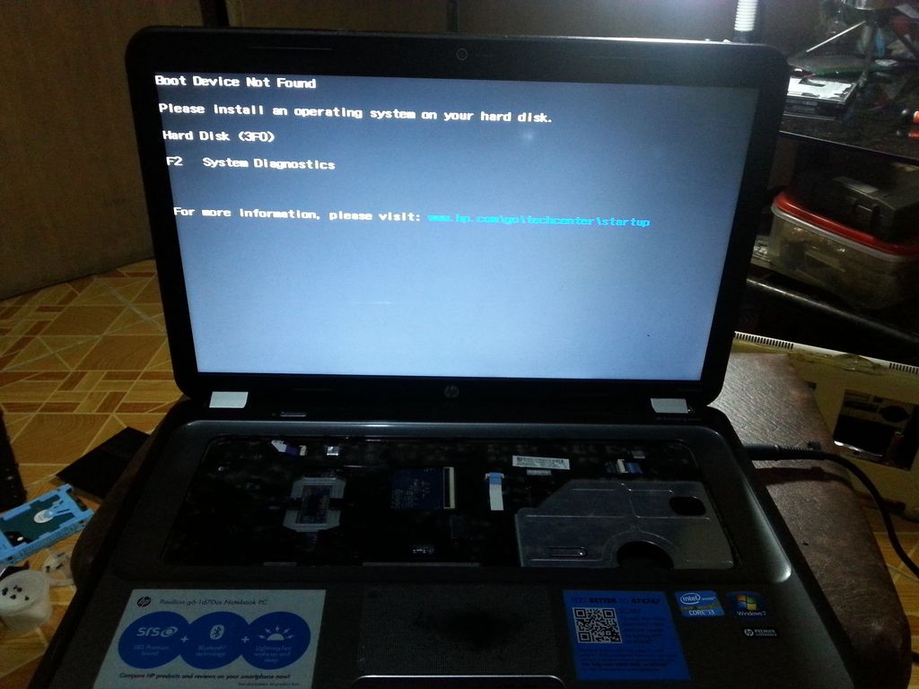

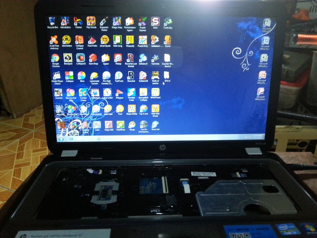

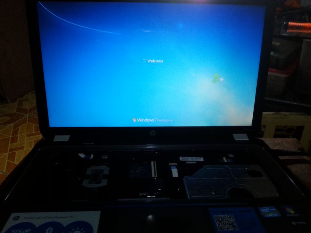

after cleaning, assemble and try without memory and HHD; ayun may display na at may power:-bd
lagay kuna ang HHD at memory done...
note; keyboard malfunction po sya... ginamitan kulang ng usb/external keyboard
