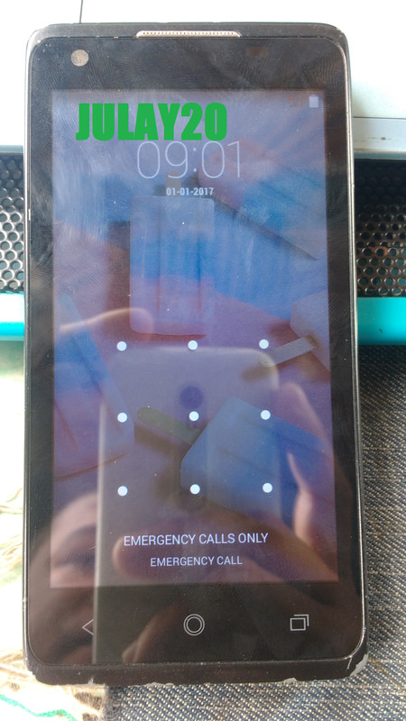

history:
naka limotan na yung password kc matagal na di ginagamit ang phone
kaya pa tangal daw ni tumer

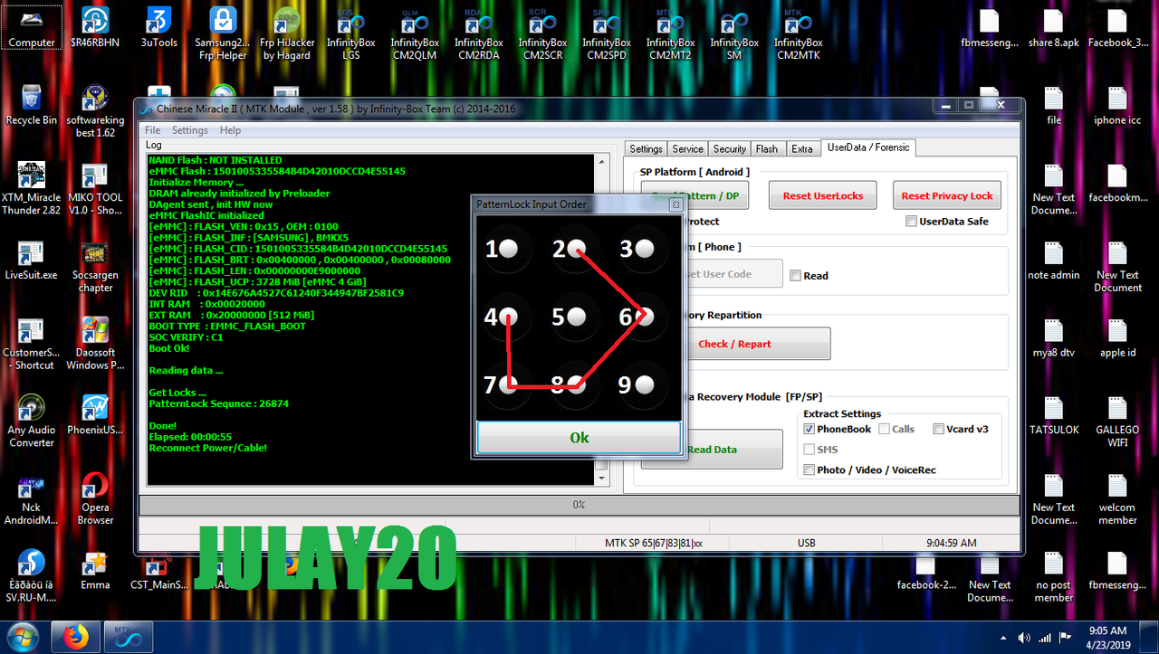

Procedure:
Open cm2 mtk
Click Settings select boot yung pangalawa
Click UserData / Forensic
Click ReadPattern / DP
no need voll up and down kc mtk namn matik na yan
saksak usb wait.... mo lang mag done!

Procedure:
Open cm2 mtk

Code:
Card found : S/N : 6CB042B6 , v0136
Chinese Miracle II [MTK module] v 1.58
Operation : Read Pattern/DP Lock [ v1.58 ]
Wait for phone...
Phone found! [ 30 ]
Sync...
Inital Boot Ok!
BB_CPU_PID : 6572
BB_CPU_NME : [MediaTek] MT6572_S00
BB_CPU_EXT : 0xCA01 , 0x8A00 , 0x0000
Processing BROM stage
Settings for BROM configured!
SecCfgVal : 0x00000000
BromVer : 0x00FF
BLVersion : 0x0001
Processing DA stage
DA Select done, will use MTK_AllInOne_DA_v3.3001.00.00
Sending and initialize DA ...
Running DA ver.4.2 on BBID : 0x88
NAND Flash : NOT INSTALLED
eMMC Flash : 1501005335584B4D42010DCCD4E55145
Initialize Memory ...
DRAM already initialized by Preloader
DAgent sent , init HW now
eMMC FlashIC initialized
[eMMC] : FLASH_VEN : 0x15 , OEM : 0100
[eMMC] : FLASH_INF : [SAMSUNG] , BMKX5
[eMMC] : FLASH_CID : 1501005335584B4D42010DCCD4E55145
[eMMC] : FLASH_BRT : 0x00400000 , 0x00400000 , 0x00080000
[eMMC] : FLASH_LEN : 0x00000000E9000000
[eMMC] : FLASH_UCP : 3728 MiB [eMMC 4 GiB]
DEV RID : 0x14E676A4527C61240F344947BF2581C9
INT RAM : 0x00020000
EXT RAM : 0x20000000 [512 MiB]
BOOT TYPE : EMMC_FLASH_BOOT
SOC VERIFY : C1
Boot Ok!
Reading data ...
Get Locks ...
PatternLock Sequnce : 26874
Done!
Elapsed: 00:00:55
Reconnect Power/Cable!
