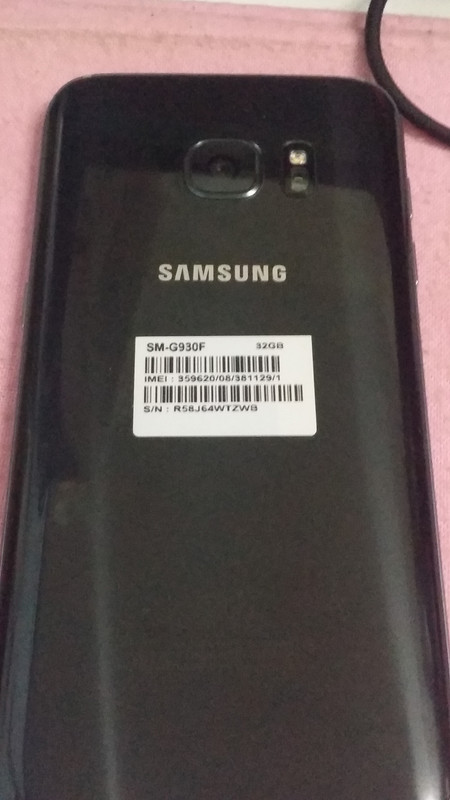

G930f read codes only(not via server)

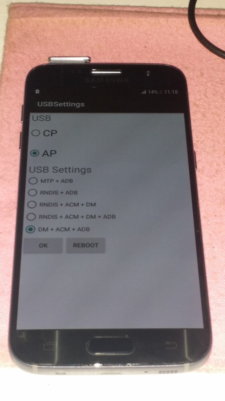

Press *#0808# and select DM+ACM+ADB and Reboot
Select Com and ADB

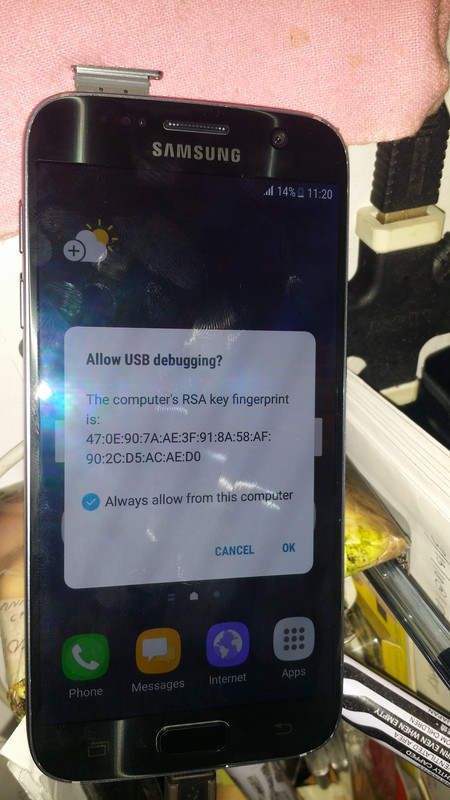

Connect usb cable and check Always allow from this computer and press Ok

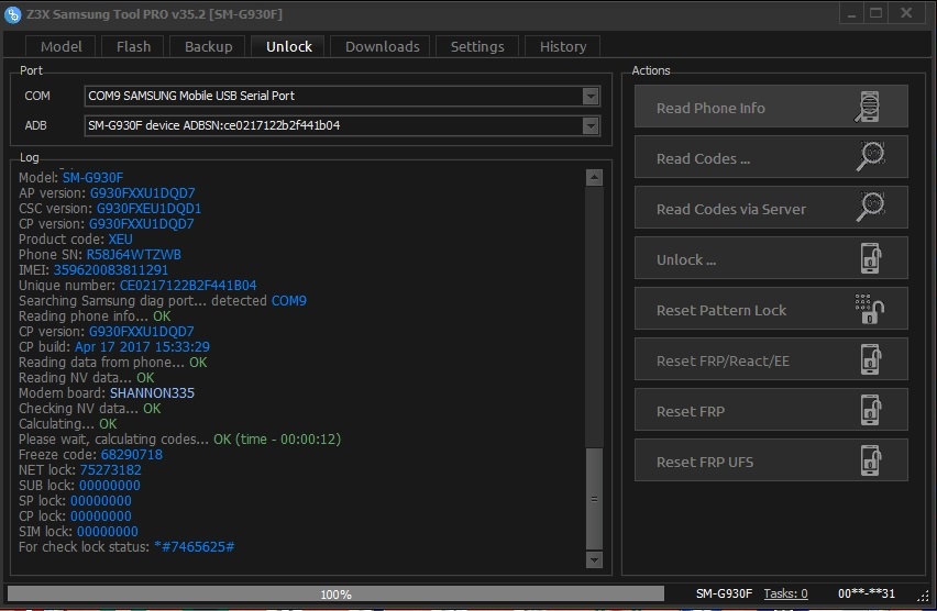

Press Read codes (not read codes via server)
