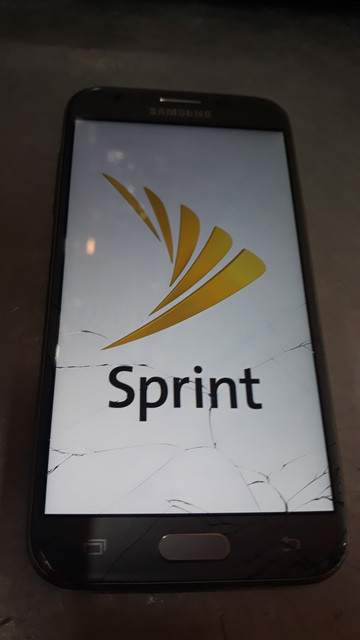

Share kulang nagawa ko mga bossing
dumating saken naka rooted na ang unit.
try ko unlock z3xprono lock try ko
sa kingstools no lock fail
kasi kaya fail ned flashing combo.
kaya.try ko sa ibang tools buti di ako na bigo. ito ang gamit ko jan na lahat mga lodi:

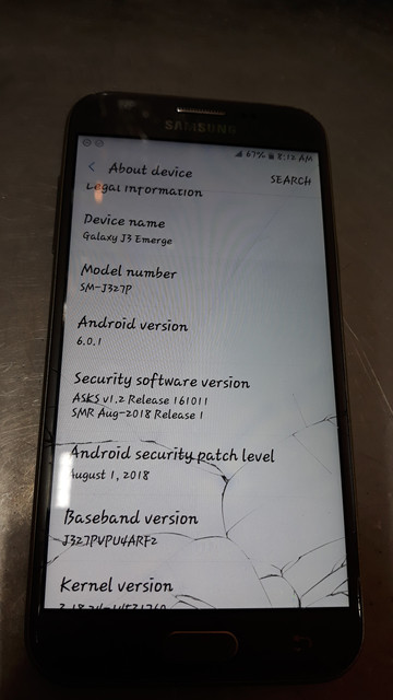

Procedure:
1. Flash J327P_U4_Unlock.tar
2. Enable Diag Port by typing ##3424# and select: DM+MODEM+ADB
3. Run NV-items_reader_writer.exe
4. Choose Port, Click on "Connect" --> "Read" and then click on "Write" option, select NV file: J327P_U4_Unlock.txt
5. Click on "Mode" --> Reset, phone will restart and will be unlocked...
Yan poh mga bossing sana makatulong...
