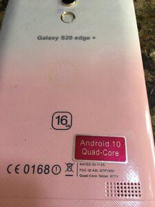

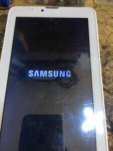

Galaxy s20 edge + china tab hang logo. no luck sa hard reset back / format data

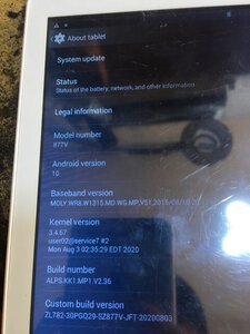

solution flashing.. kaso mahirap hanapan ng flash file mabuti nkachamba.. 3 firmware , as last try dito sya nag ok
MODEL TAB: GALAXY S20 edge + / 877V
MAINBOARD ID: ZL782_MB_V2.1
ANDROID VERSION: 10
backup nio muna firmware nio para incase ndi match may pambalik kayo..

flash 3 files lang para less ang error
SYSTEM-DATA-CACHE lang muna ang iflash.. yan lang lagi ginagawa co pag mga china
ayun success!
ANDROID VERSION: 10
ayun success!
