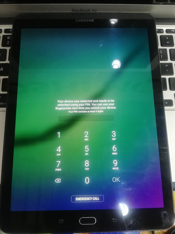

STATUS: Nakalimutan ang password.

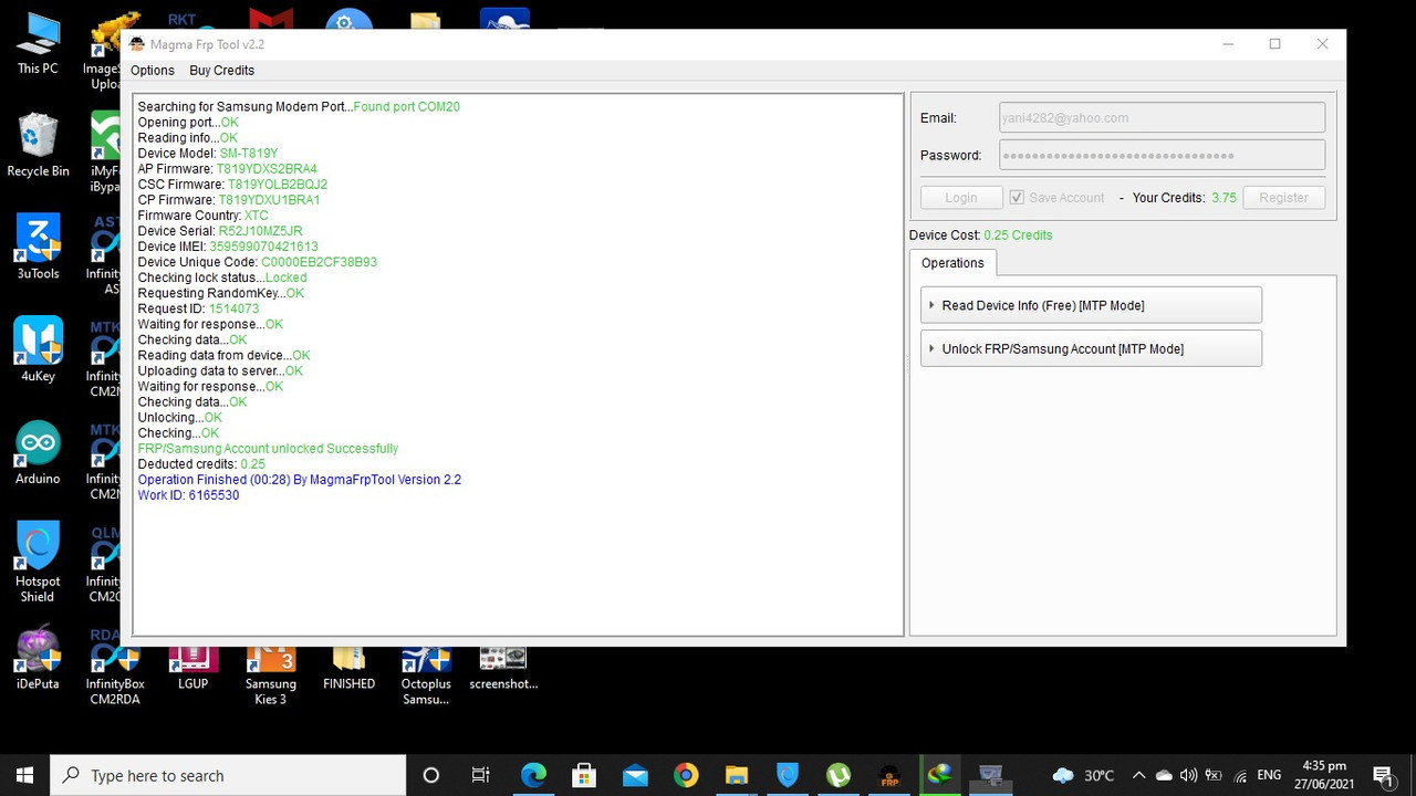

ACTION TAKEN: Bypass using MAGMA TOOL done
pero may password pa rin.
Sinubukan kung e hard reset pero ayaw dahil
naka MDM lock.

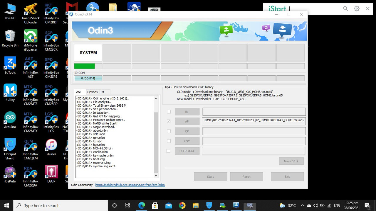

SOLUTION: Flash combination file via ODIN

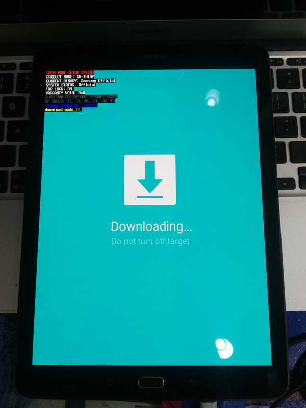

Power off tab s2
Hold volume down and home button and power to download mode
Inset usb cable
Open ODIN
Click APP
Load combination file
click start
done
After ma flash sa combination file naka BINARY MENU na ang unit
Go to settings then reset.
Power off tab s2
Insert usb cable

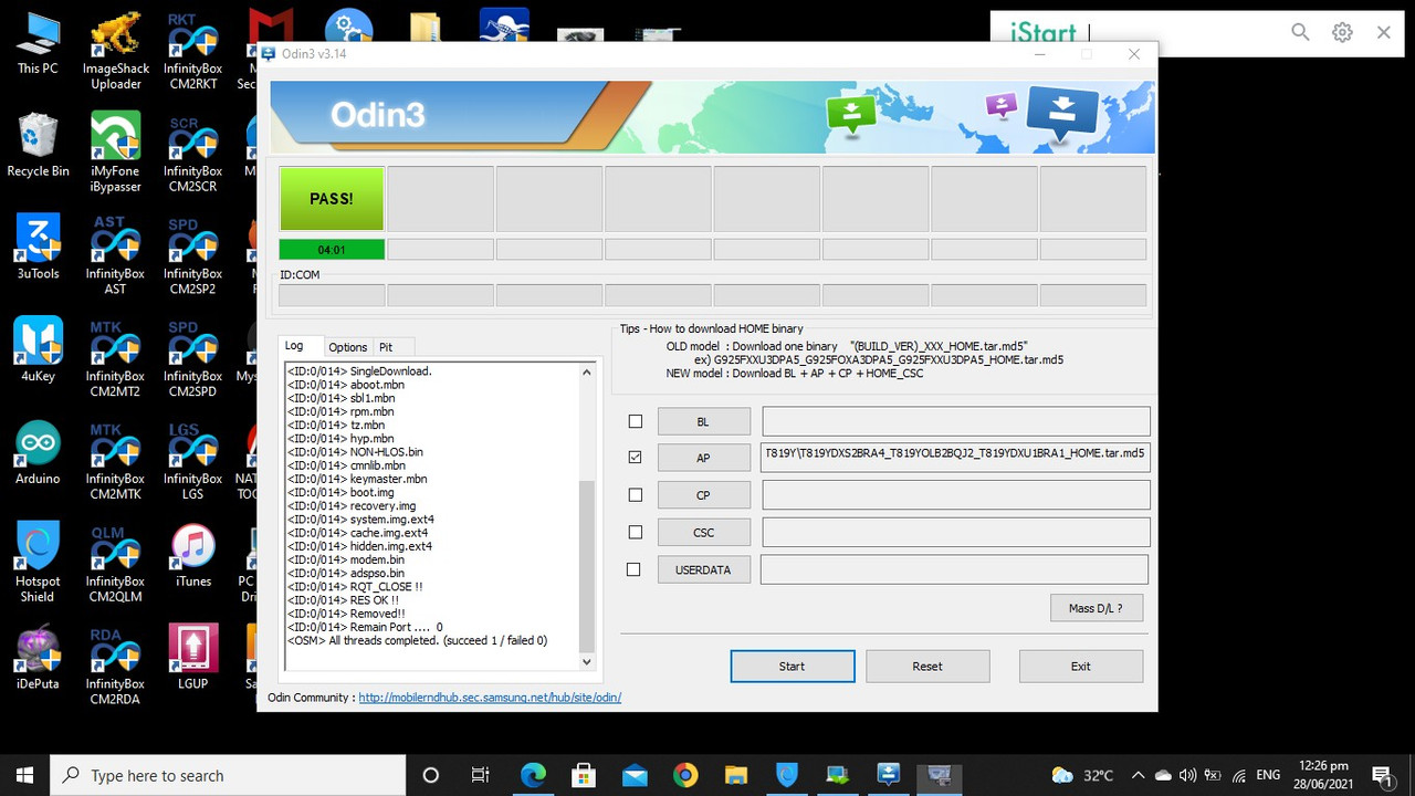

Open ODIN
Click APP
Load original firmware
Click start
done.
