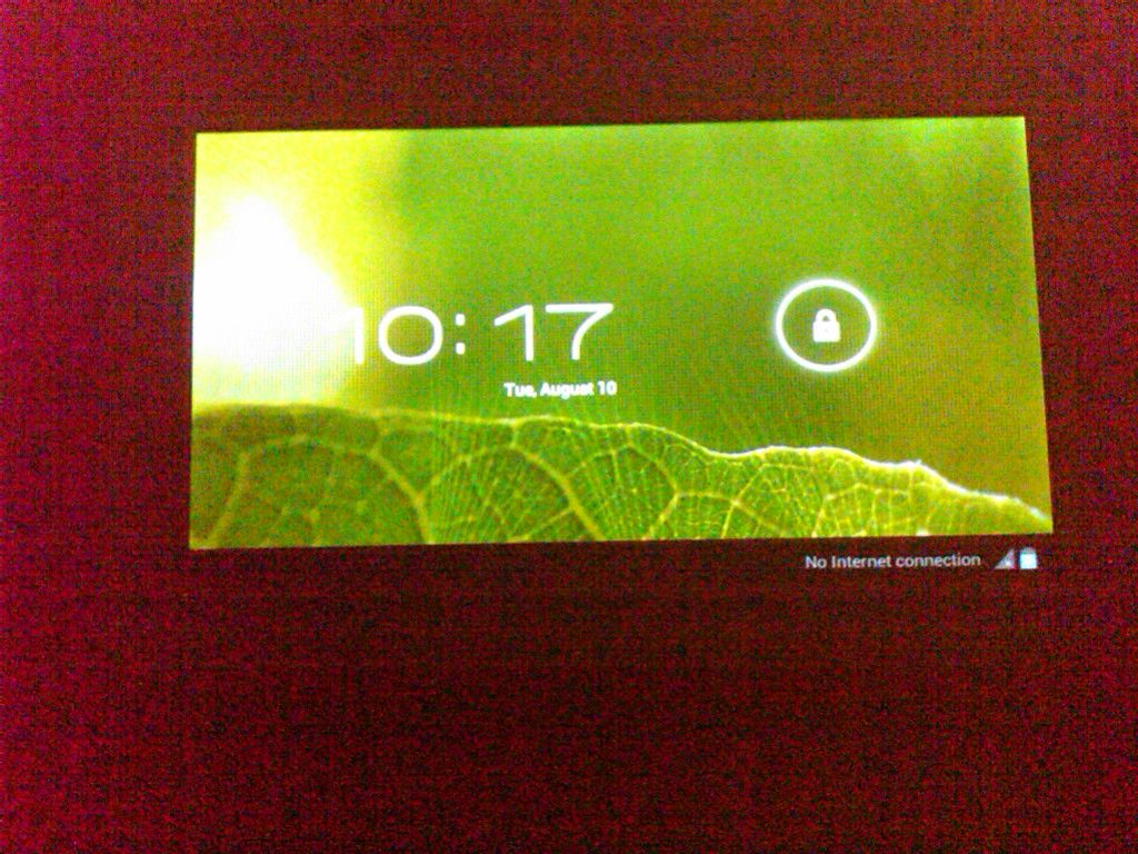

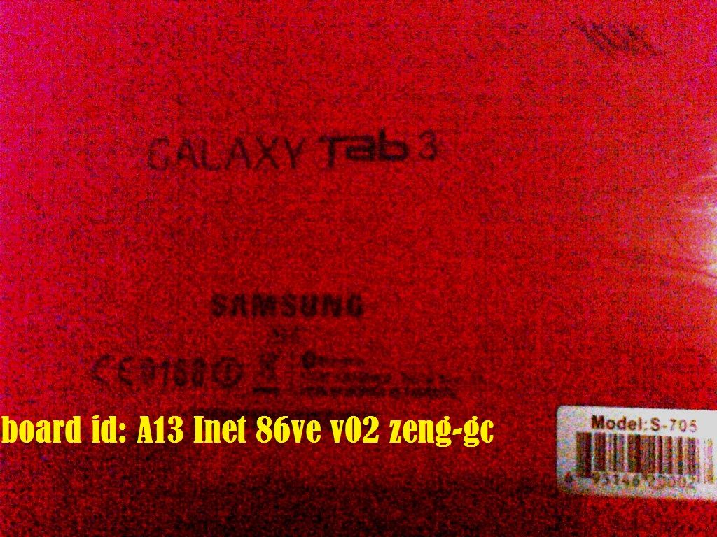

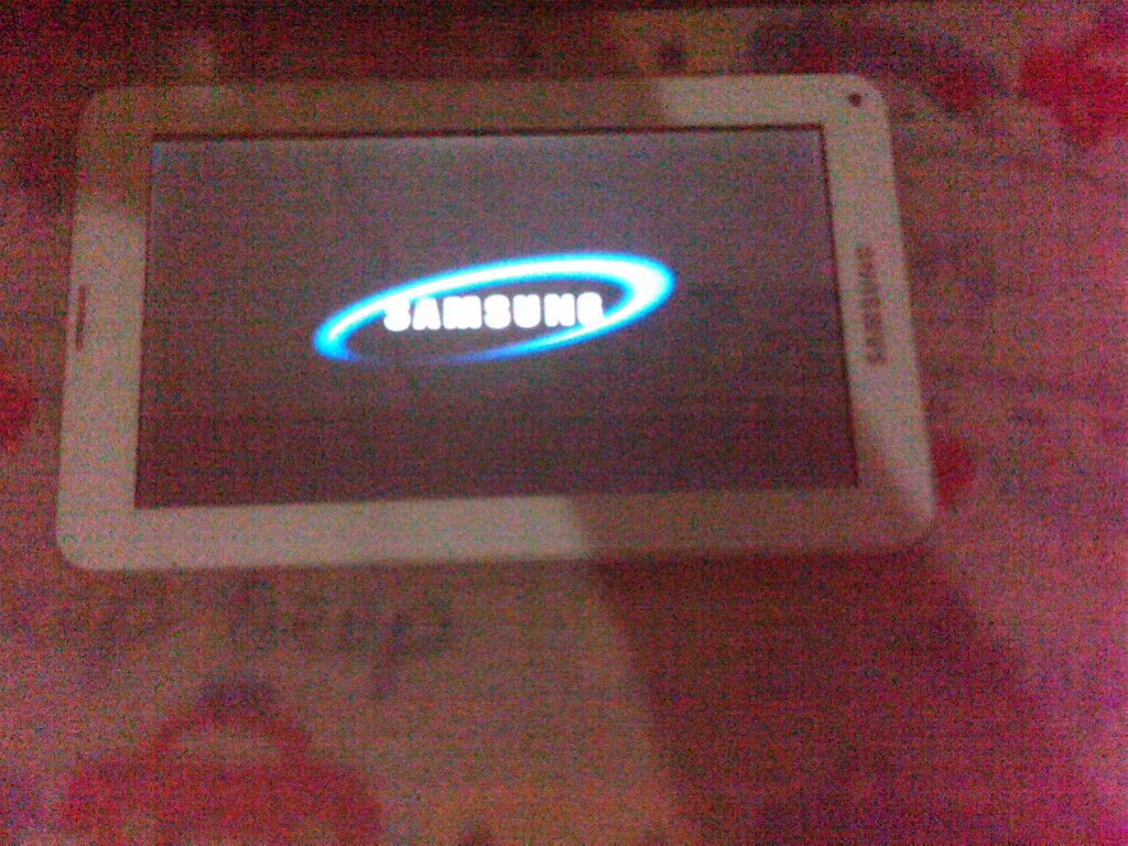

share ko lang po tong galaxy tab3 hang sa logo

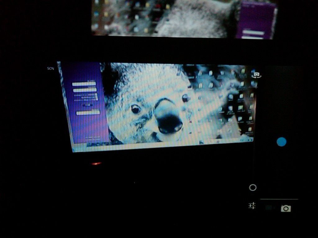

back camera

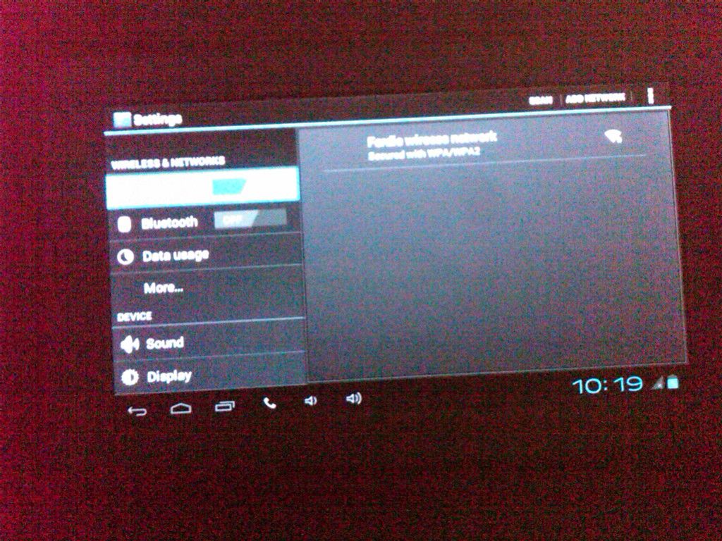

wifi

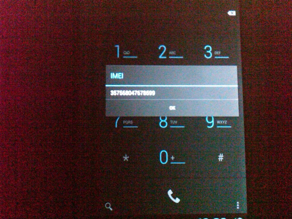

Imei

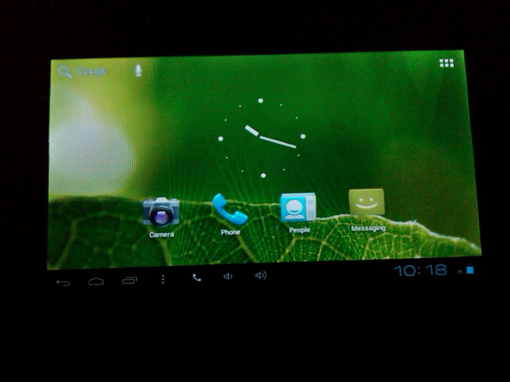

done

Action taken
hardreset- same problem

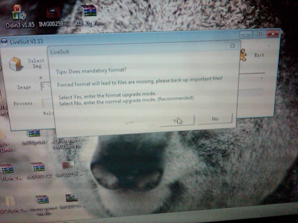

try flashing using phonixcard and livesuite+ exact firmware- failed
ayaw pumasok flashing
next ko ginawa ito
open livesuite
Load FW
then wait for flashing to be completed
next ko ginawa ito
open livesuite
Load FW
