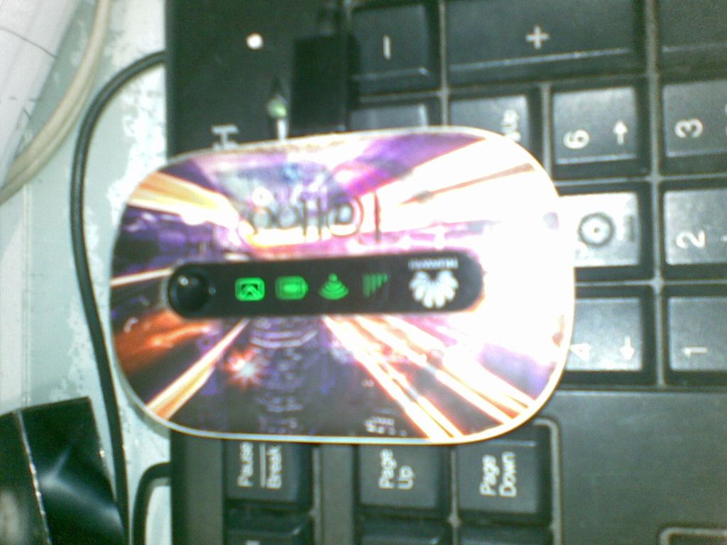

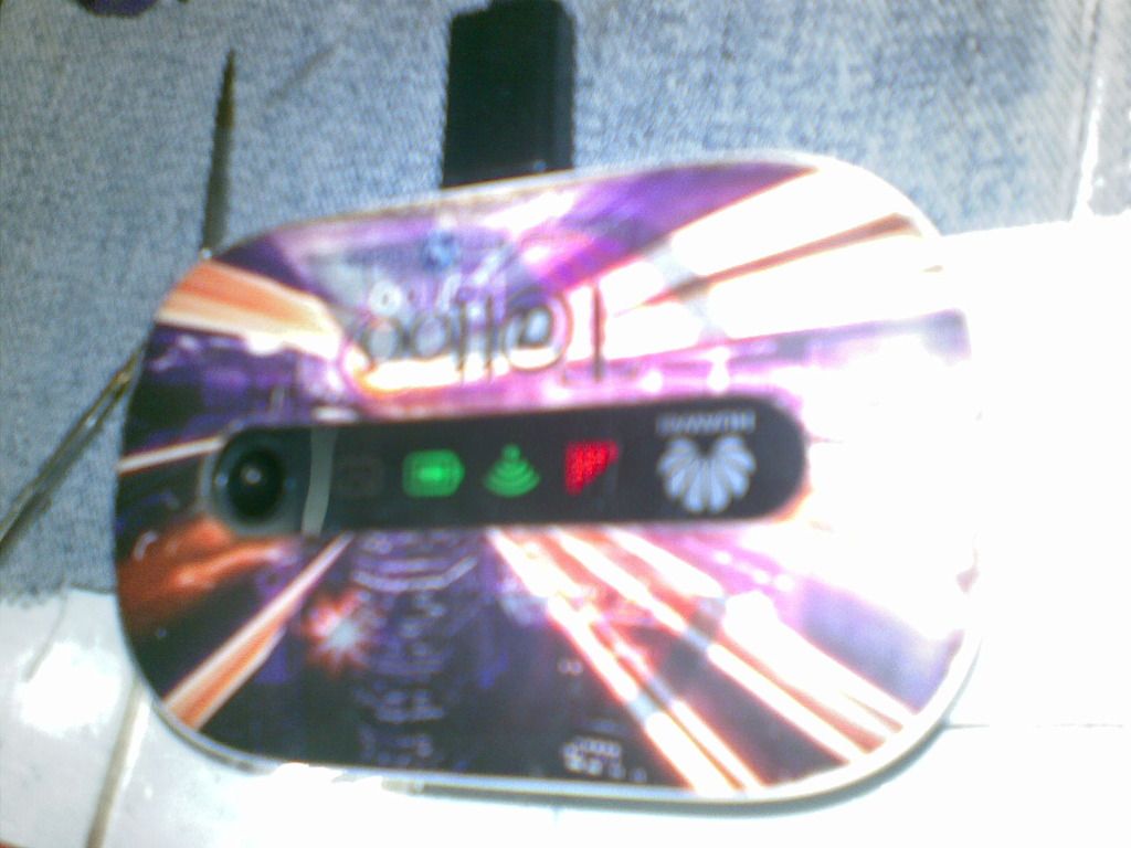

gud pm po mga master share ko lang as refference itong nagawa ko huawei pocket wifi E5220-S blinking only
history na iwan ng naka charge buong gabi at nagka ganun na lang blinking na lang ng gamitin sana ng may ari

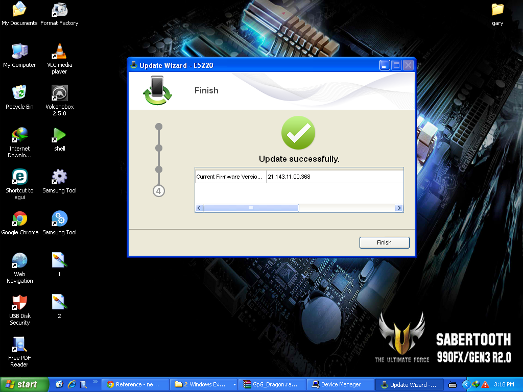

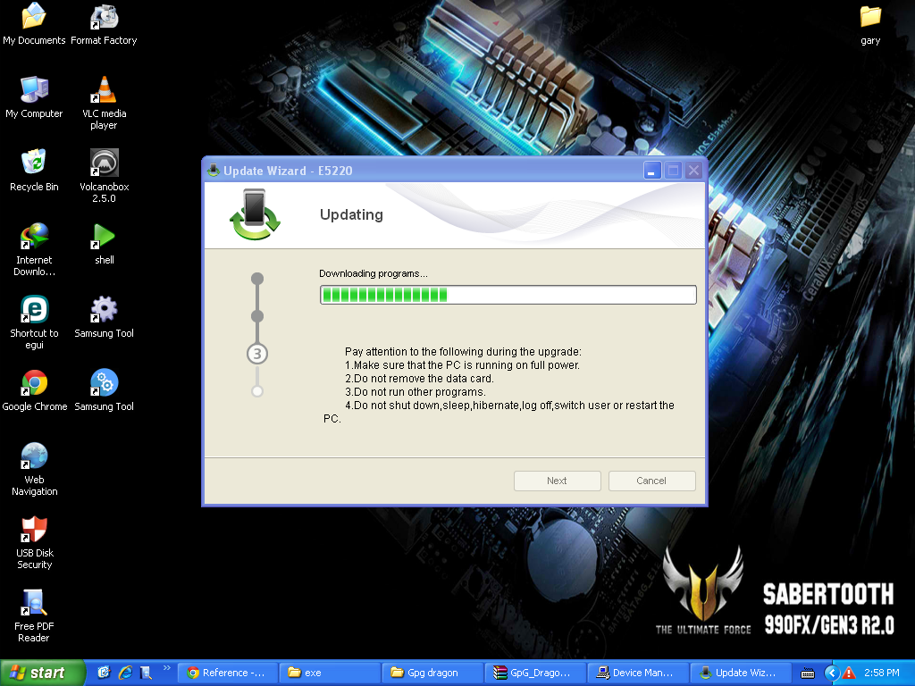

open nyo yan a tapos click exe then start upgrade by pressing next button and wait for a few minutes and your done
