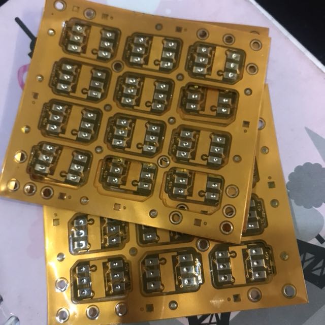

about for GPP CHIPS nid updated ios version para mag working c gpp chips edit iccid
sample pic. kinoha kolang kay pareng google
Example iphone 6s ios version 12.1.2 insert GPP chips input new iccid.

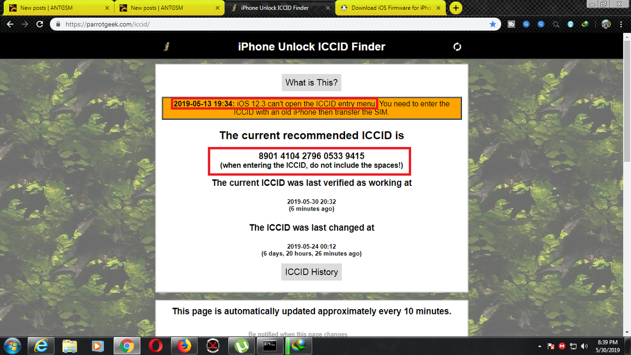

https://parrotgeek.com/iccid/
see the image yong my guhit na red yan yong new iccid sa parrokgeek.com tested yan 101% kakatry kolang
sabi ni parrokgeek ios 12.3 working iccid so means niyan. hndi pa working yong ios 12.3.1..

connect to wifi click HOME BOTTON dial *5005*7672*00# click edit iccid input this new code nasa 2nd image yong parrok.geek

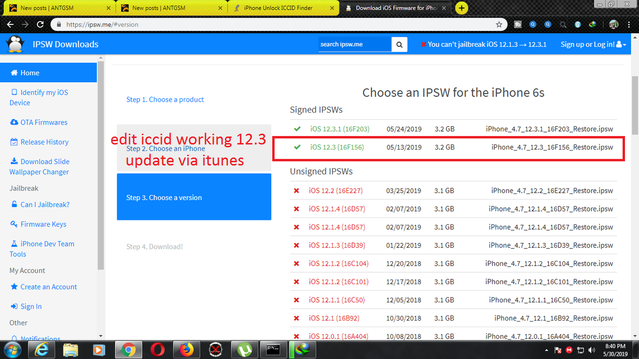

pagkatapos remove gpp.. 3rd image download ios 12.3. pasok dito https://ipsw.me/#version tapos ma download update using itunes. dapat nka normal mode lang yong phone then PRESS SHIFT+RIGHTclick
hanapin lang yong na download mo kong san na.ilagay
tapos ma update connect wifi ulit paslak c gpp kasama yong sim TAPOS my cgnal
