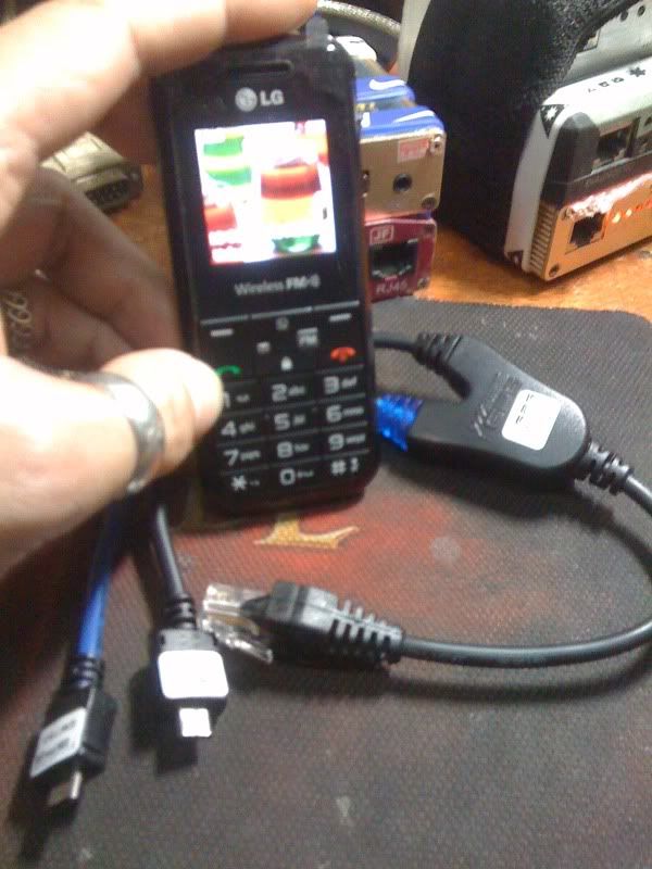

** GS108 from Telstra unlockdone via GPG GS102/GM750 Vygis combo cable *
296
297
AltF4
Sep 3, 2014
1,285
-cable used GPG GS102/GM750 Vygis combo cable ( use GS102)
-open vygis infineon tool LGI tool
-select USB-RS232 on Port-Setting
-select GS108 model
-use GS102 rj45 cable
-press Connect Port
-press Connect Phone
-insert cable to phone [phone without battery]
-ress power on until full info displayed
-press read unlock code
-follow vygis instructions in entering codes
