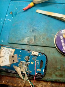

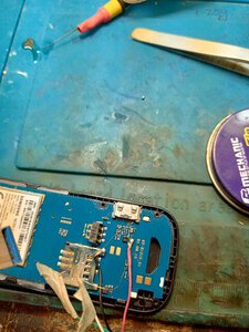

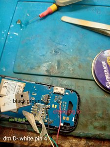

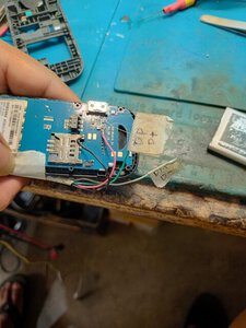

conversion USB port heto Ang ways tested Kuna
1.color green dp D+ soldiring in pin number 5
2.color white dm D- soldiring in pin number 4
3.red charging ic scratch no sa tabi nya at soldiring mo.
4.black ground
done
