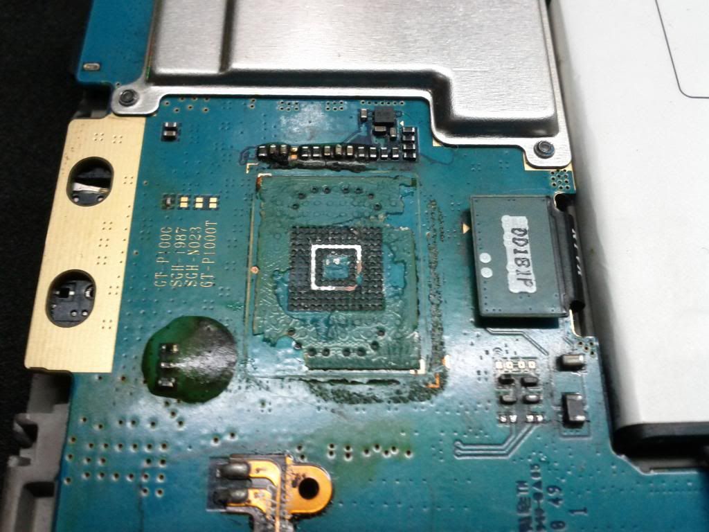

PHONE STATUS:
Samsung Galaxy Tab GT-P1000 EMMC chip already removed
from other shops, JTAG pinouts already tampered.
Tablet is in deadboot status.
PREPARATIONS:
1. Download from MEDUSA support site GT-P1000 full flash.bin
2. Prep solder JTAG pinouts.
3. Insert atleast 4BG micro sd shoud be inserted before flash.

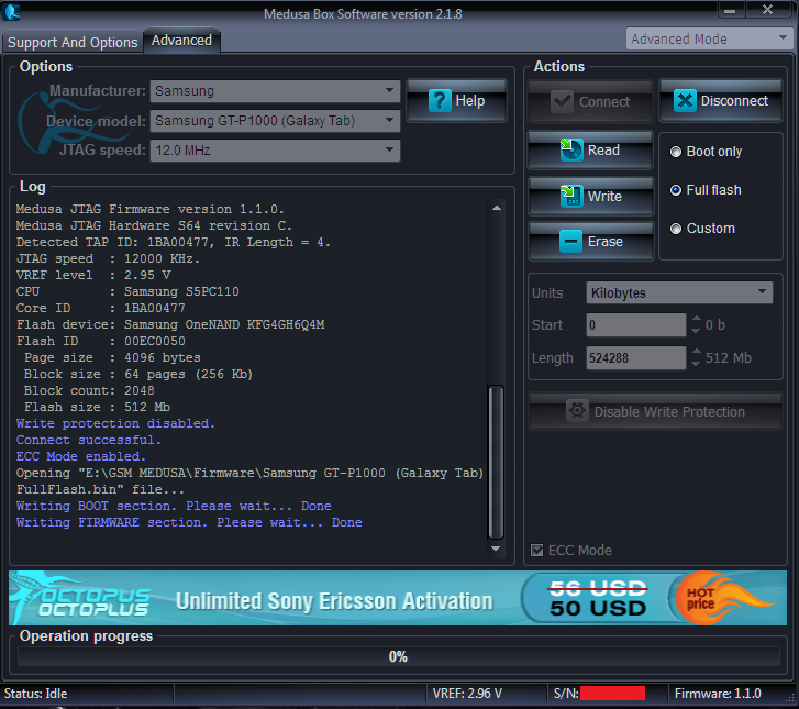

MY CONNECTION:
MEDUSA JTAG FULL FLASHING:

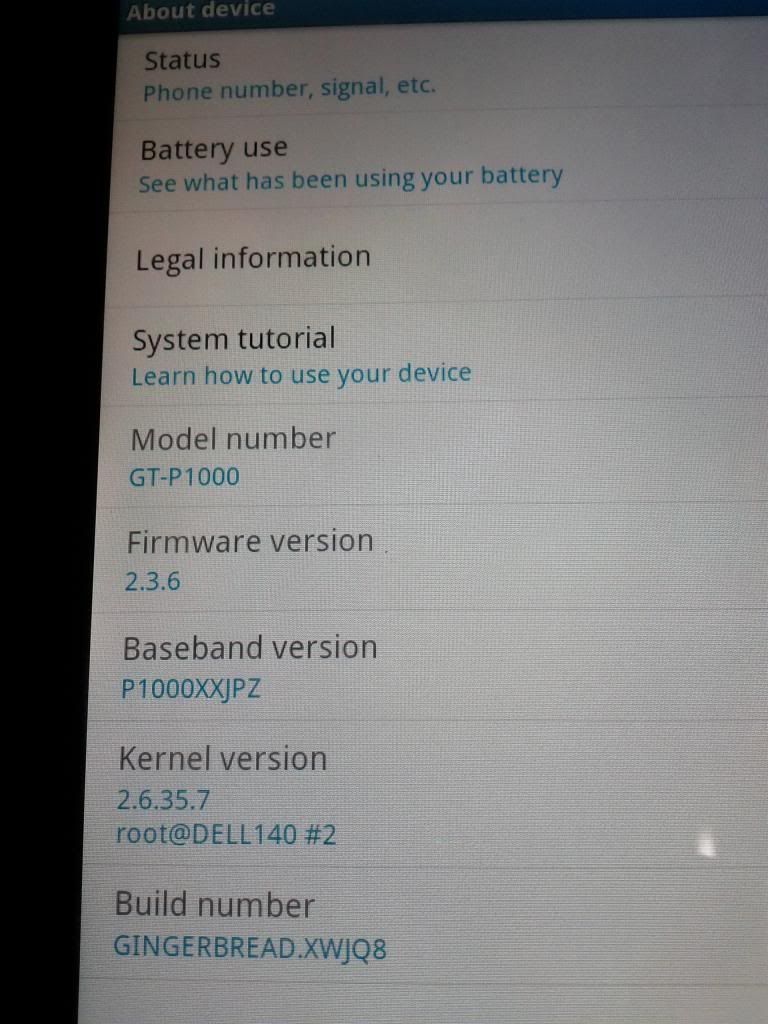

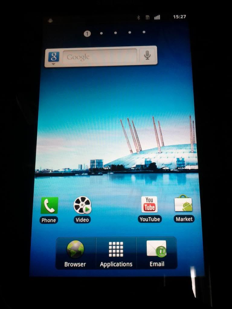

After Jtag flashing, tablet now power on normally,
pero need IMEI repair.

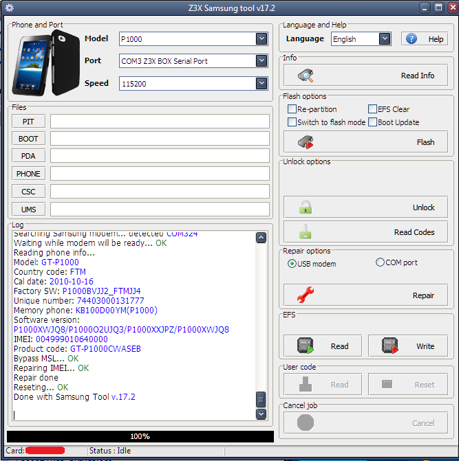

EFS and IMEI REPAIR:
(Z3X po ang ginamit ko, ayaw kc madetect ng maayos un tab sa OCTOPUS)
1. Open Z3X Samsung Tool
2. Connect tablet
3. Click "Repair" button
4. Check box "Repair EFS"
5. Check box IMEI and enter the tablet original IMEI.
6. Click "OK" button and until finished.
Code:
Log started at 3/20/2014 4:11:30 PM ...
Welcome to Medusa Box Software version 2.1.8
Operating Mode: Advanced Mode
Selected device model: Samsung GT-P1000 (Galaxy Tab)
Connecting. Please wait...
ERROR[034]: RTCK signal does not respond. Defaulting to 1 MHz.
Medusa JTAG Firmware version 1.1.0.
Medusa JTAG Hardware S64 revision C.
Detected TAP ID: 1BA00477, IR Length = 4.
MI: Halting target, attempt 1.
MI: ARM CoreSight DAP detected.
MI: CPUID = 43110221.
JTAG speed : 1000 KHz.
VREF level : 2.97 V
CPU : Samsung S5PC110
Core ID : 1BA00477
MI: Loading Medusa Device Server V1.2.
MI: Starting...
MI: Received status 0x0000F00F, cycle 0.
MI: Received server capabilities 0x00000135.
MI: Detailed server caps: FLASH, ECC, WDOG, DWP, IOCTL
MI: Watchdog are preconfigured.
MI: Server init.
MI: Received flash ID 0xB0EC0050.
MI: Flash geometry set.
MI: Recheking settings... ok
Server caps : 00000135
Flash device: Samsung OneNAND KFG4GH6Q4M
Flash ID : 00EC0050
Page size : 4096 bytes
Block size : 64 pages (256 Kb)
Block count: 2048
Flash size : 512 Mb
Write protection disabled.
Connect successful.
ECC Mode enabled.
Erasing BOOT section. Please wait... Done
Erasing FIRMWARE section. Please wait... Done
Opening "E:\GSM MEDUSA\Firmware\Samsung GT-P1000 (Galaxy Tab) *********.bin" file...
Writing BOOT section. Please wait... Done
Writing FIRMWARE section. Please wait... Done
Target device has been disconnected ...

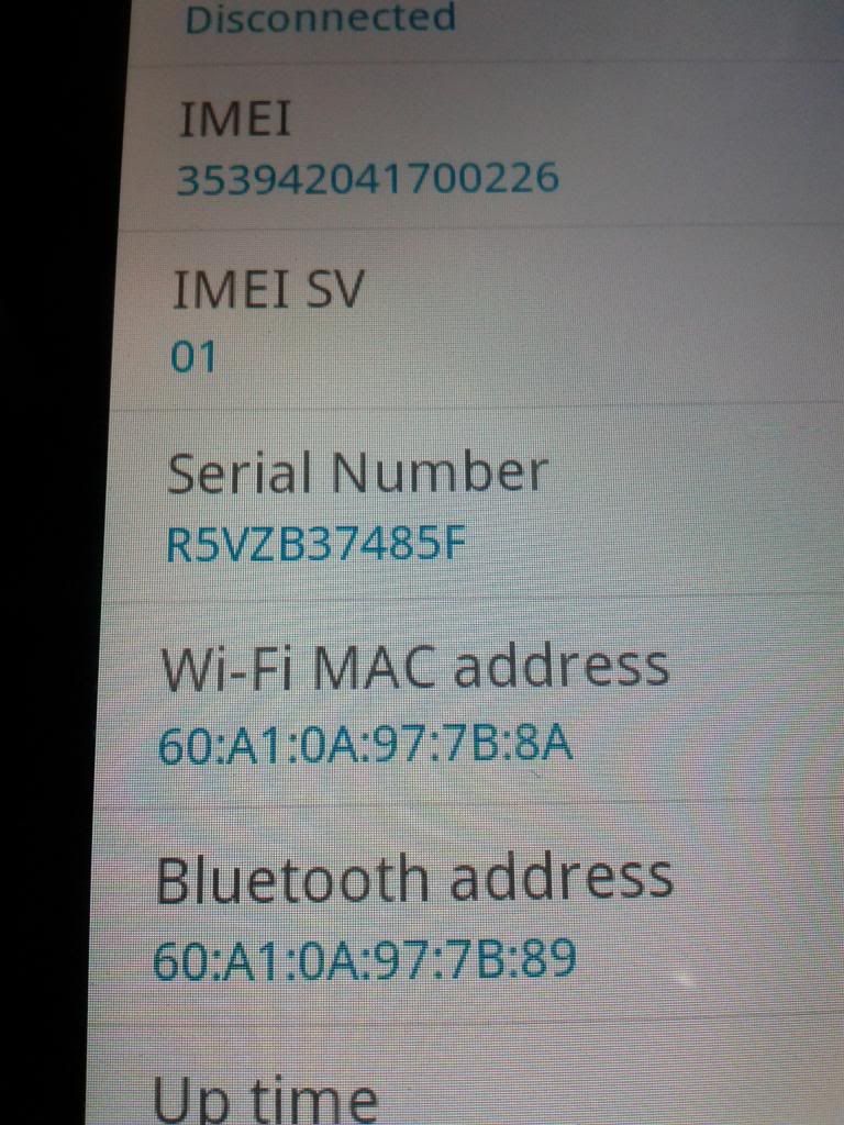

2. Connect tablet
Code:
Selected model: P1000
Selected port: COM3 Z3X BOX Serial Port
Selected port speed: 115200
Reading phone info...
Model: GT-P1000
Android version: 2.3.6
Product code: Unknown
Phone version: Unknown
PDA version: P1000XWJQ8
CSC version: P1000O2UJQ3
IMEI: null
Phone S/N: Unknown
Checking Super user right... true
Writing EFS to phone... OK
Rebooting phone... OK
Searching Samsung modem... detected COM324
Waiting while modem will be ready... OK
Model: GT-P1000
Country code: FTM
Cal date: 2010-10-16
Factory SW: P1000BVJJ2_FTMJJ4
Unique number: 74403000131777
Memory phone: KB100D00YM(P1000)
Software version: P1000XWJQ8/P1000O2UJQ3/P1000XXJPZ/P1000XWJQ8
IMEI: 004999010640000
Product code: GT-P1000CWASEB
Bypass MSL... OK
Repair done
Reseting... OK
Done with Samsung Tool v.17.2
Model: GT-P1000
Phone version: P1000XXJPZ
Phone S/N: R5VZB37485F
Reading data from phone... OK
Writing data to phone... OK
Model: GT-P1000
Country code: FTM
Bypass MSL... OK
Repairing IMEI... OK
Repair done
Reseting... OK
