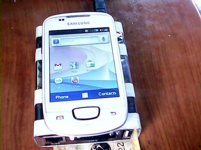

UNIT: SAMSUNG GT-S5570
PROBLEM: HANG & RESTART sa samsung logo at error flashing sa ODEN,Z3X & OCTOPUS.

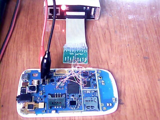

any jtag box basta supported ang unit (RIFFBOX)
fully charged battery or regulated power supply para sa matagalang flashing (more than 1 hour)
some jtag servicing experence
PROCEDURE:
solder all jtag wire interface (pinout)

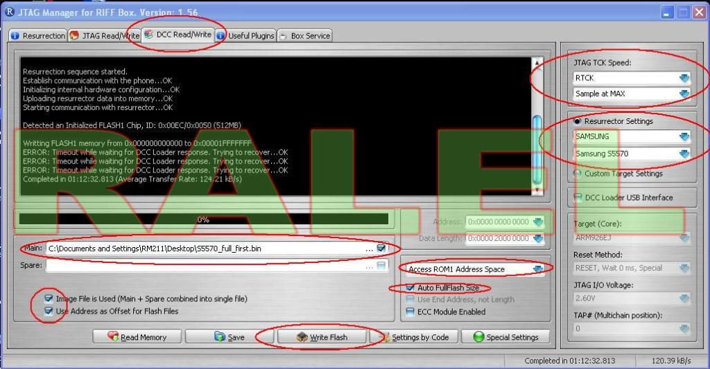

run riff jtag manager
select model (samsung / GT-5570)
go to DCC READ / WRITE TAB
select acces ROM1 addres space
check auto fullflash
check main & browse for the file to be use (S5570_full_first)
check image file is used & use adress as offset box
click setting by code & select write full image into NOR/EMMC memory then apply code
click write flash and wait untill done
see screenshot for more details
