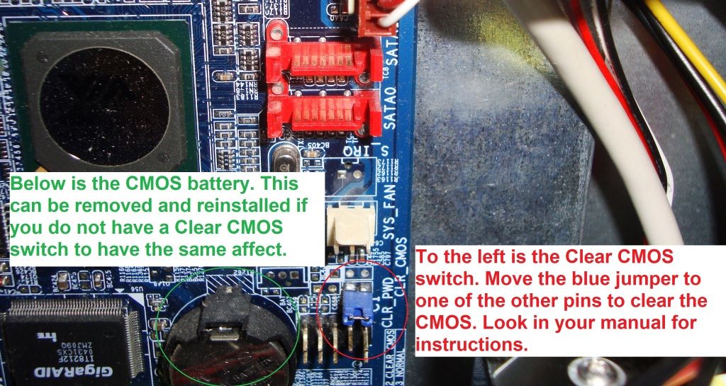

Check your CMOS battery and settings
#2 If the beep code indicates that there is something wrong with the CMOS, or a System Time failure, you need to either remove the CMOS battery, or if your motherboard has one, use the Clear CMOS jumper or button (most have a jumper, some of the higher-end boards tend to have a Clear CMOS button) – consult your motherboard manual for instructions on how to do this.

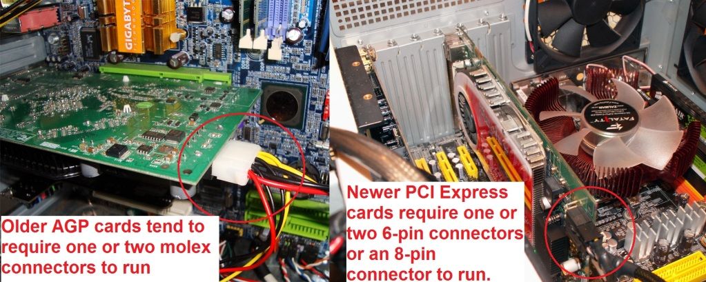

#3 If the beep code indicates that you have some sort of video error, make sure your graphics card is working correctly. Take it out and test it in another computer if possible, if not, reseat your graphics card and see if it works then.
Also make sure you have connected any additional power cables the card may need. Older AGP graphics cards may require one or two molex connectors to be plugged in to them in order for them to work. Newer PCI Express graphics cards may require one or two PCI Express 6-pin power connectors plugged into them. The higher-end PCI Express graphics cards require 8-pin PCI Express power connectors. Make sure your power supply has the connectors you need, and that the correct cables are plugged into the graphics card(s). Most lower-end cards do not require any additional power.
Higher end graphics card (such as this Radeon 5870 below, which I own ) require either two 6-pin power connectors or one 6-pin power and one 8-pin power connector in order to run. Check your graphics card to make sure you have connected all the appropriately power connectors. It's best to practise NOT to use molex to PCI Express power connector adapters. If you have a card such as the 5870 or anything else which requires two or more power connectors, get a decent power supply witch already comes with the correct number of power cables.
As you can see one of the 6-pin power connectors has an extra 2-pins you can add onto the plug to make an 8-pin power connector. If you have a card which requires at least one 8-pin connector, make sure you do this if your PSU does not already have an 8-pin connector.

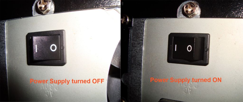

Those pesky switches on the back of power supplies...
#2 Check to see if the switch on the back of the power supply is switched OFF. If it is, turn it ON, and try to turn on the computer. If the computer does not power on even once you have made sure the switch on the back of the PSU is turned on, the cable could be the problem. Check the fuse to make sure it’s OK, and try using the same power cable in your monitor or on another PC to check if the cable is faulty.

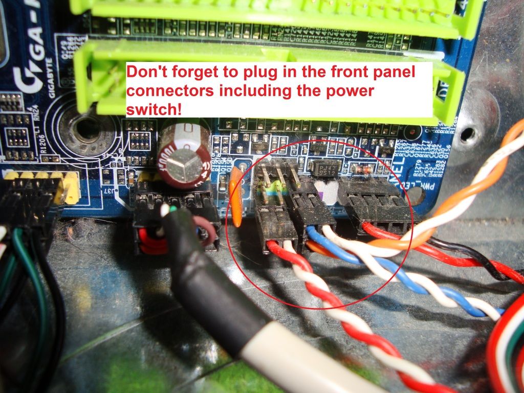

Make sure you've actually plugged in your power switch into the board!
#3 Check to see if you have accidentally dislodged or forgotten to plug in your power switch wires into the motherboard. If you are building a new system and forgot to connect the power button wires, you are a muppet. Plug them in in the correct place (consult your motherboard manual) and see if the PC boots. Also make sure you plug the cables into the correct ports on the board, if you plug them into the wrong ports or pins, the PC isn’t going to boot. Usually the location of the ports where the front panel connectors plug into is located towards the bottom right hand corner of the motherboard.

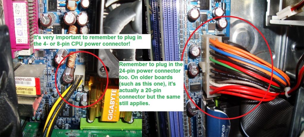

Make sure everything is connected
#4 Check to make sure everything is plugged in. Check 24-pin (or 20-pin on older motherboards) motherboard power and 4-pin/8-pin (depending on PSU and motherboard) CPU power connector especially. The location of the board power is 99 times out of 100 located on the far right of the board. The location for the CPU power varies, but it is usually around the CPU socket.
Also check 6-pin PCI express on graphics card if there is one, or if you are using an older AGP graphics card, make sure you have plugged in a molex connector should your card require one. Sometimes cable management can result in cables becoming dislodged or completely disconnected. If you have done cable management in your case, make sure the cables do not have too much stress exerting on them, otherwise they can come lose and in some cases can prevent the PC from booting.

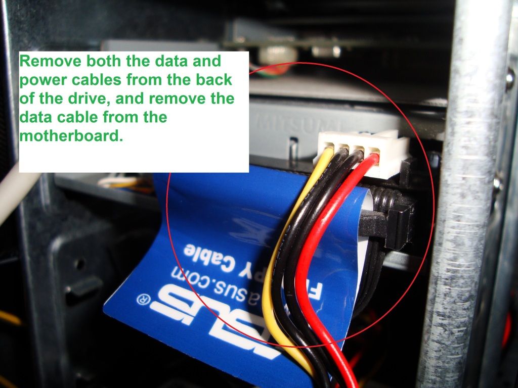

Disconnect any floppy drives, they're horrible those things
#5 If there is a floppy drive, remove it or unplug it. Often the floppy connector shorts on connecting to the floppy itself, preventing the PC from booting.

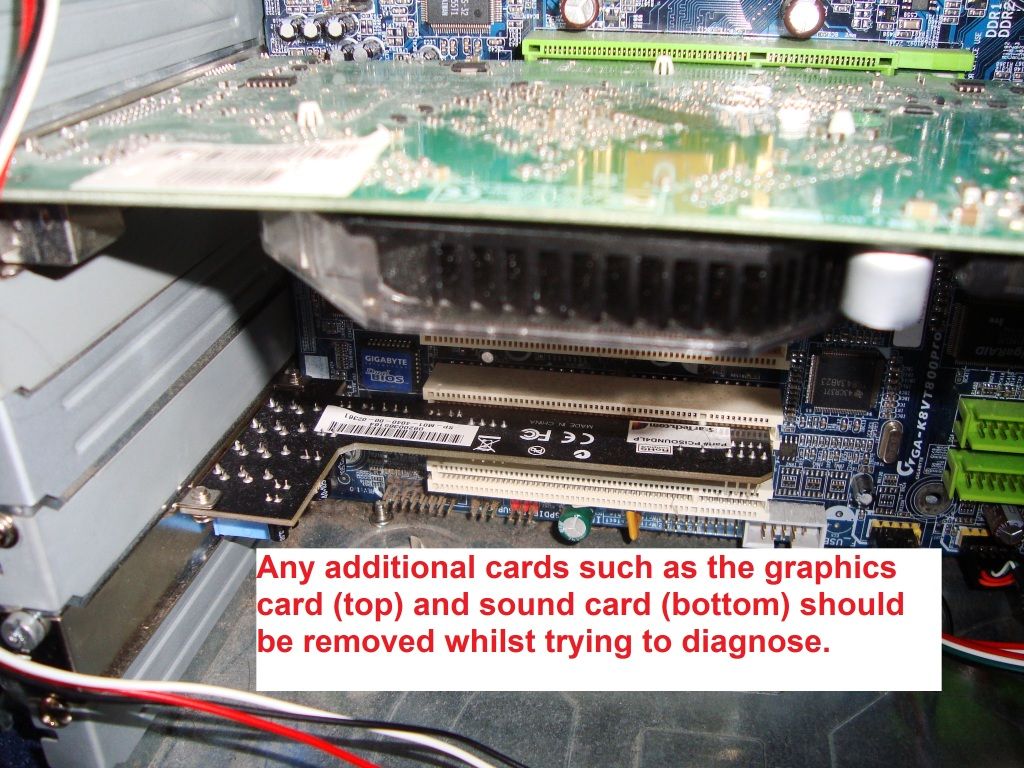

Remove any PCI expansion cards you may have
#6 Start removing or reseating any extra PCI expansion cards such as modems, additional USB cards, sound cards, TV tuners, firewire cards etc etc. Remove one by one and test to see if the PC will boot after you have removed. Eg - remove sound card, see if the PC boots, if it doesn't, remove modem, see if the PC boots etc etc. You need to do one at the time in order to work out what is preventing the PC from booting.
Or you could remove any expansion cards and gradually add them one by one, testing each time., this would be the inverse of the above.

#10 Try clearing or reseating the CMOS and/or BIOS. In the vast majority of systems, you will just be able to move the Clear CMOS jumper or Clear BIOS jumper in order to clear the CMOS and BIOS, but in some systems you may have to remove the CMOS battery and reinstall it. Consult your motherboard manual for help.
