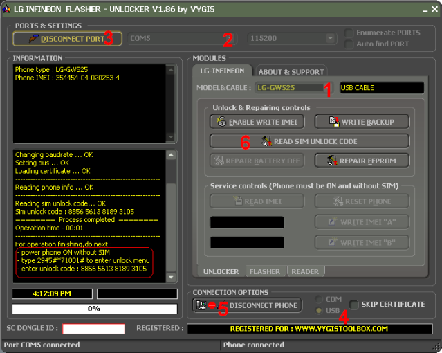

GW525G Successfully unlocked
Tools;
Vygis Box
CA-101 cable
Procedure;
1. Select Phone Model
2. Select COM Port
3. Click Connect Port
4. Select USB option
5. Click Connect Phone
6. Click Read SIM unlock code
7. Power ON phone without SIM
8. Type 2945#*71001# for Unlock Menu
9. Enter unlock code
