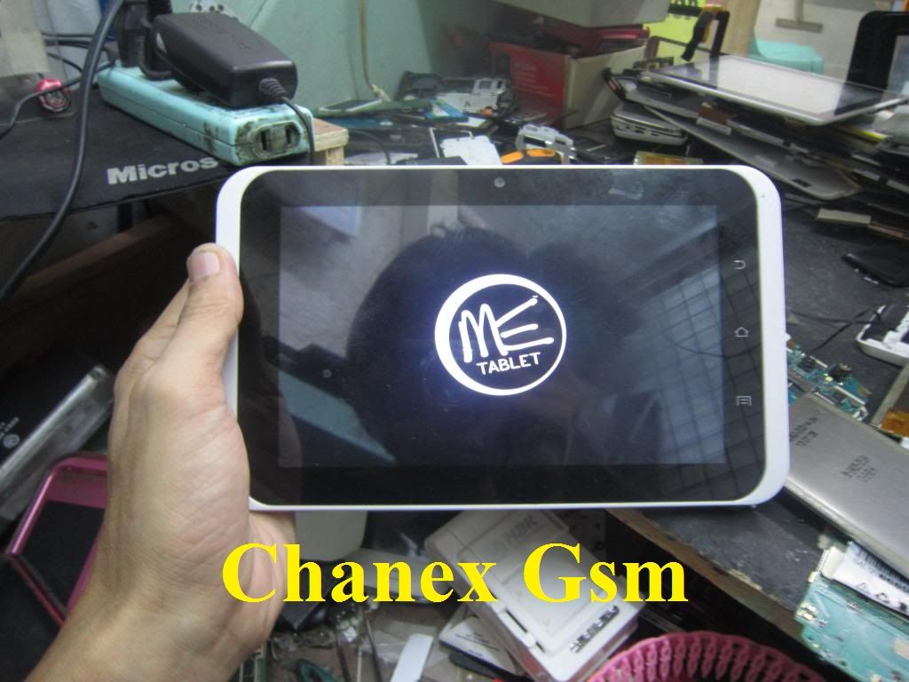

HCL ME TAB Y2
PROCEDURE :
FIRMWARE:
PROVIDE ATLEAST 1 GB MICRO SD
FORMAT MICRO SD IN FAT32
EXTRACT THE RAR FIRMWARE AND COPY ALL CONTENT TO MICRO SD
INSERT THE MICRO SD TO THE TABLET

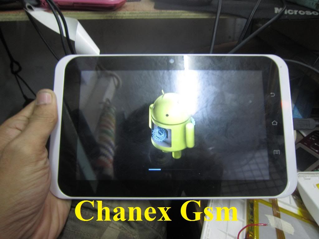

PRESS POWER AND VOLUME UP AT THE SAME UNTIL UPGRADING APPEAR AND RELEASE IT
AT ITO NA SYA UPGRADIN NA
