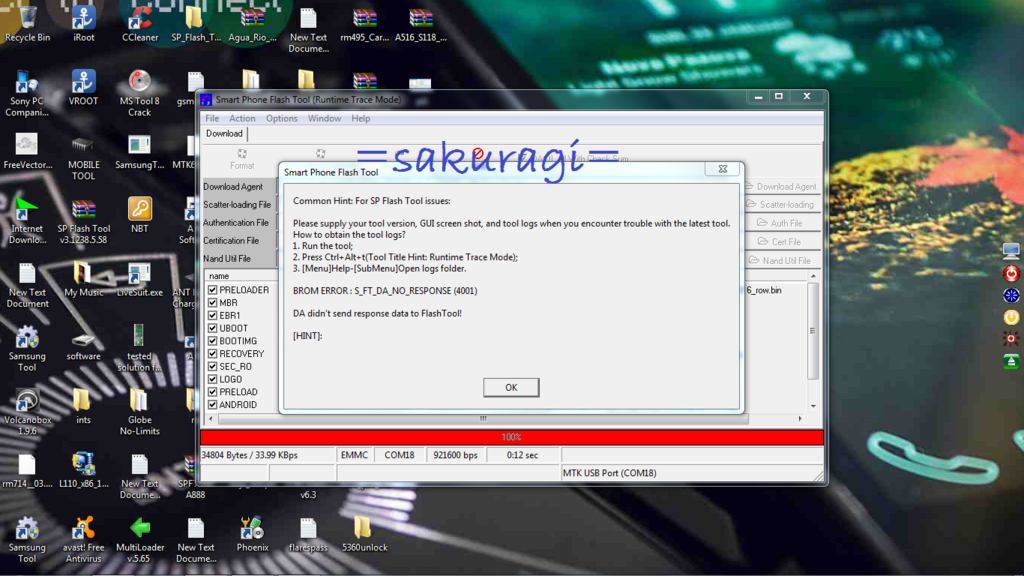

mga kaAntz need ko po idea nyo dito, Lenovo A516 no power, history bigla lang daw namatay, action taken flash ko unit sa sp flash tool kaso lagi error, nagamit ko na ibat ibang version ng SPT, 2 firmware same problem, ito po SS:
in this case,
Meaning: SP flash tool is having difficult to communicating with the device
try ,Change the USB-port and transfer SP Flash Tool to the root of your main hard drive ( C: ) then run as admin..and make sure that you have install the correct drivers...
secondly,
maybe the CPU/Memory IC'S totally damage need to reball or replace.
