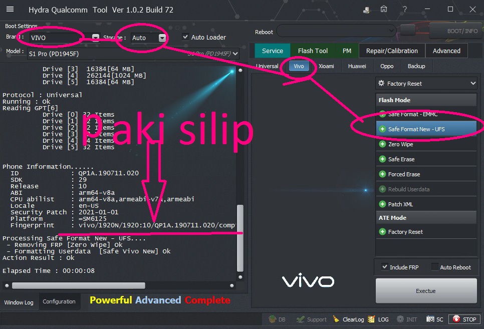

pakisilip yung may arrow pag natapos, sir
PreOperation Configuration
Brand : AUTO Model : AUTO Storage : Auto
Loader: Auto
Port : Auto
Searching for Qualcomm 9008 Device...Found
FriendlyName :Qualcomm HS-USB QDLoader 9008 (COM17)
SymbolicName :\??\USB#VID_05C6&PID_9008#6&23b6cea8&0&1#{a5dcbf10-6530-11d2-901f-00c04fb951ed}
Driver Ver :07/08/2015,2.1.2.0
Getting device info..Ok
Device MODE : Firehose
Connecting to Firehose...
Ping..................... Ok
Configuration........
Identifying Chip........UFS
Ok
Chip Configuration :
MemoryName : UFS
MaxPayloadSizeToTargetInBytes : 1048576
MaxPayloadSizeToTargetInBytesSupported : 1048576
MaxPayloadSizeFromTargetInBytes :
MaxXMLSizeInBytes : 4096
TargetName :
Version : 1
DateTime : Sep 9 2020 - 00:57:45
*** STORAGE DEVICE INFO ***
Memory Type : UFS
Block Size in Bytes : 4096
Page Size : 4096
Manufacturer ID : 429
Serial Number : 2037279096
Firmware Version : 110
Product Name : H9HQ16AFAMMDAR
Physical Partitions : 6
Total Logical Blocks:
Drive [0] 30939136[118.023 GB]
Drive [1] 2048[8 MB]
Drive [2] 2048[8 MB]
Drive [3] 16384[64 MB]
Drive [4] 262144[1024 MB]
Drive [5] 16384[64 MB]
Protocol : Universal
Running : Ok
Reading GPT[6]
Drive [0] 32 Items
Drive [1] 32 Items
Drive [2] 32 Items
Drive [3] 32 Items
Drive [4] 64 Items
Drive [5] 32 Items
Phone Information......
SDK : 29
Release : 10
ABI : arm64-v8a
CPU abilist : arm64-v8a,armeabi-v7a,armeabi
Locale : en-US
Security Patch : 2021-02-01
Platform : =SM6125
Fingerprint : vivo/1920N/1920:10/QP1A.190711.020/compiler02031009:user/release-keys
Processing Safe Format New - UFS....
- Removing FRP [Zero Wipe] Ok
- Formatting Userdata [Safe Format - UFS] Ok
Action Result : Ok
Elapsed Time : 00:00:08
