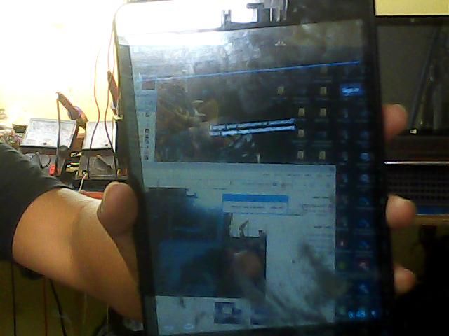

share ko lang..for reference
model: cherry mobile fusion storm
problem: too many patern attempt
PROCEDURE:

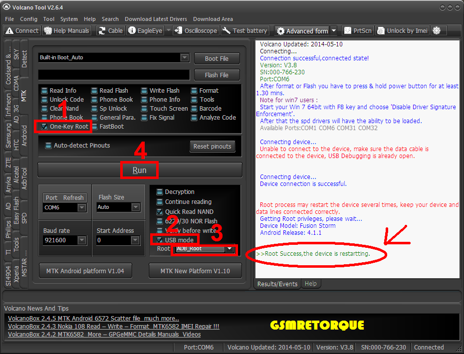

open VOLCANO
USE 5310 USB
CHECK USB MODE
CLiCk ADB_ROOT
Then run

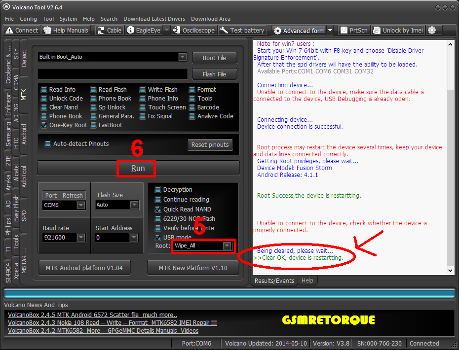

after root
click wipe_all and run
wait till finish

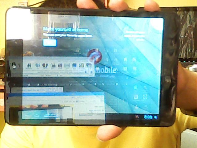

done
