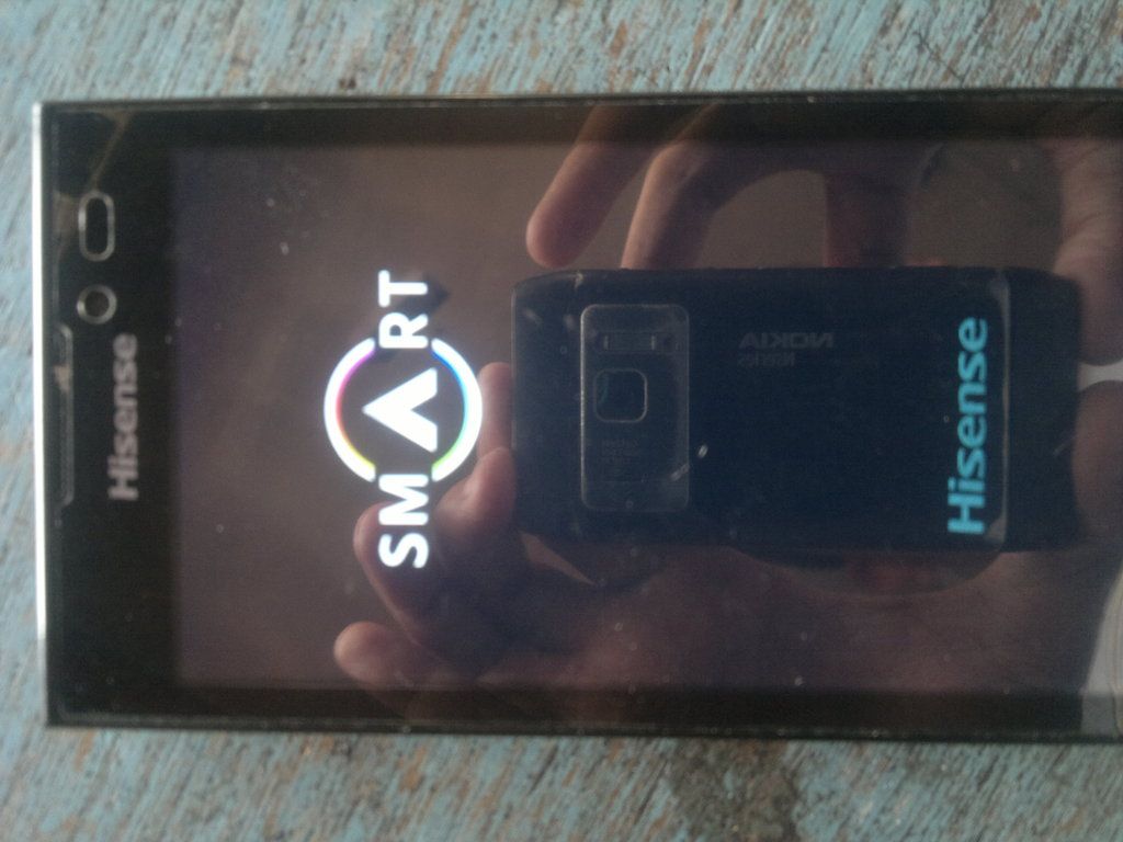

share ko lang mga bossing di daw kinaya sa katapat eh wla daw makuha back up
hisense hang done in spft
first step .hanap muna firm kay uncle google
sucess sabi ko sa cust meron makukuha

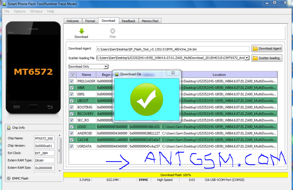

proceed n s flashing
- Unpack FlashTools, and Click on Flash_tool.exe
- Select "scatter-Loading" and search MT6572_Android_scatter.txt in ROM
- Wait file to be added into Flash Tool
- Select "Download Only" or if upgrade "Firmware upgrade"
- Turn off your phone, remove the battery (if the battery is removable) and replace it after some seconds (and don't turn on the phone).
- Press “Download†button to start
- and connect your phone into the computer via USB data cable.
- The process will start and a red progress bar will appear after color purple, yellow.
- And green circles display

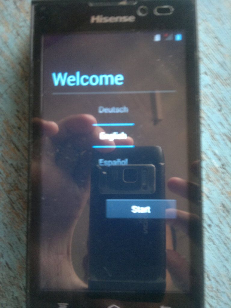

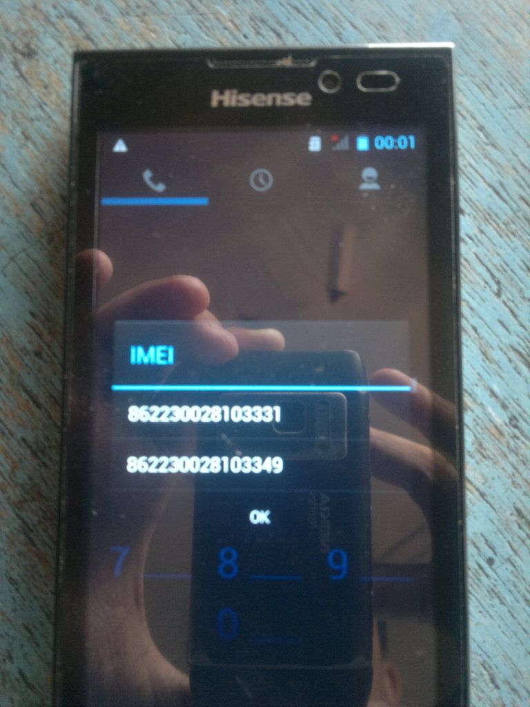

- Finish !
- You can now safely disconnect your phone and turn it on.
finish product
