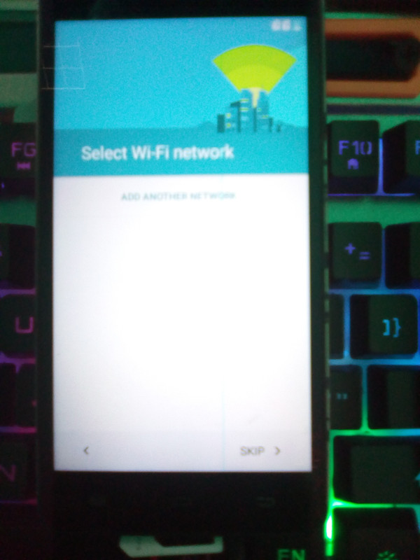

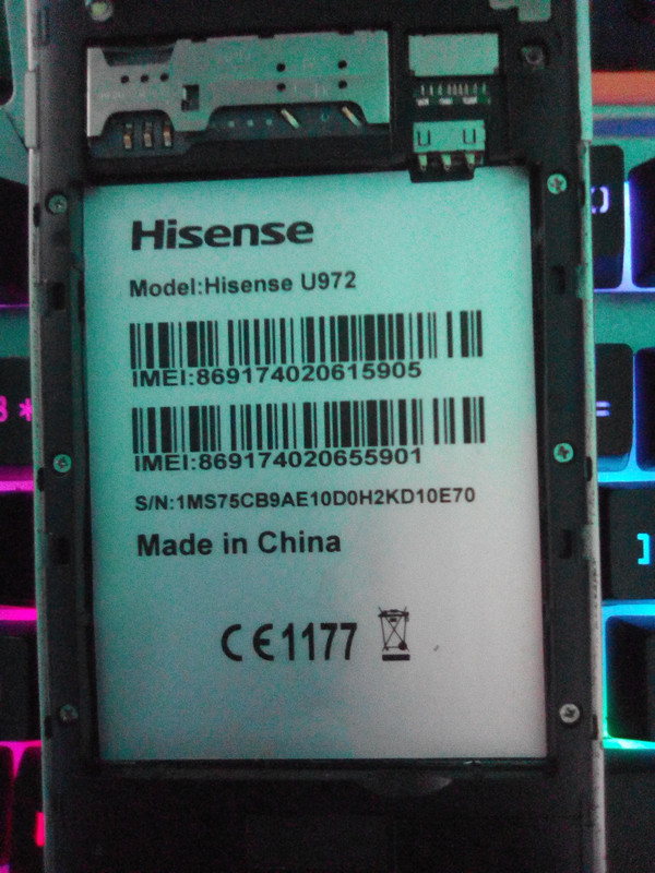

dala ni tumer nereset daw nya nag kaganyan na,,, try q sya sa crack in fast boot mode,,,, sapul,,,

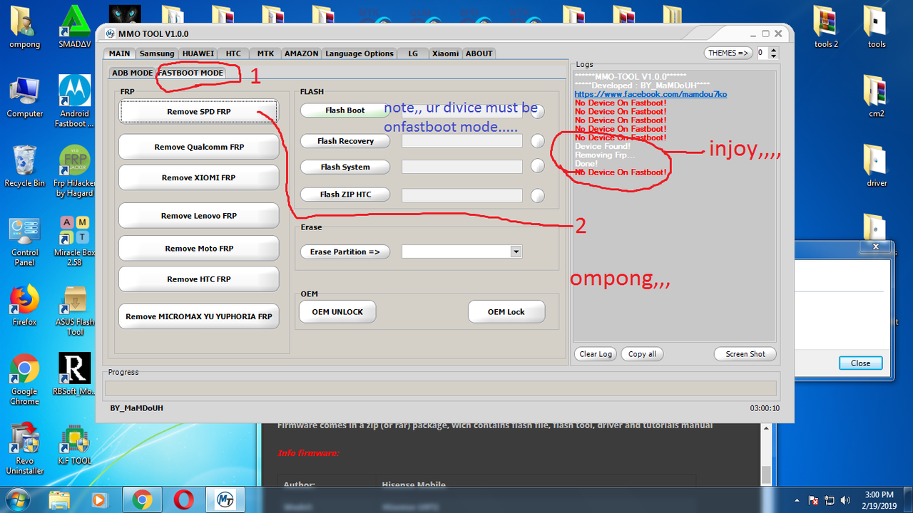

procedure''''
e on ang unit sa fastboot mode bago isalpak ang usb cord,,, paanu? press vol-and on hanapin si reboot to bootloader at pindutin gamit ang power on,,at nasa fastboot mode kna,,
image,,,,,

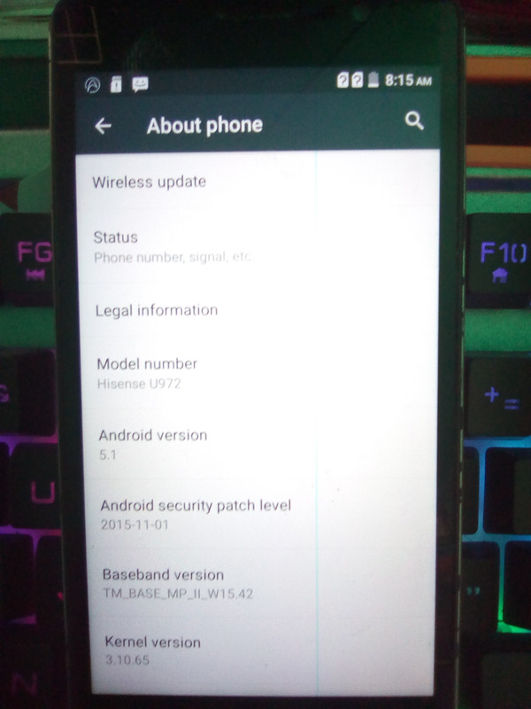

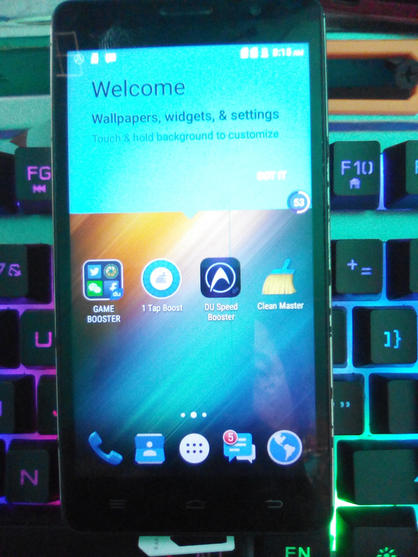

finish....
ito yung tools
https://mega.nz/#!Hzo33Y4K!J79LYRvGbc1W83WPC8BphY4tKGqnXJZ_dLRwY0o5-Ok
yung tools ang malaki ang pakinabang haha kc yung unit spd lng,, o ryt,,,,
