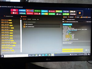

REFERENCE Honor 10 lite frp done by Unlocktool

1.) Baklas unit muna, then remove battery
2.) Open unlocktool select Huawei, select model [Hisilicon kirin 710 FRP]
3.) Test point muna then connect cable.
Yung test point Po isearch nyo nalang Po Kay uncle GOOGLE
4.) Select [USB 1.0 erase FRP]
Wait nyo nalang Po until done
