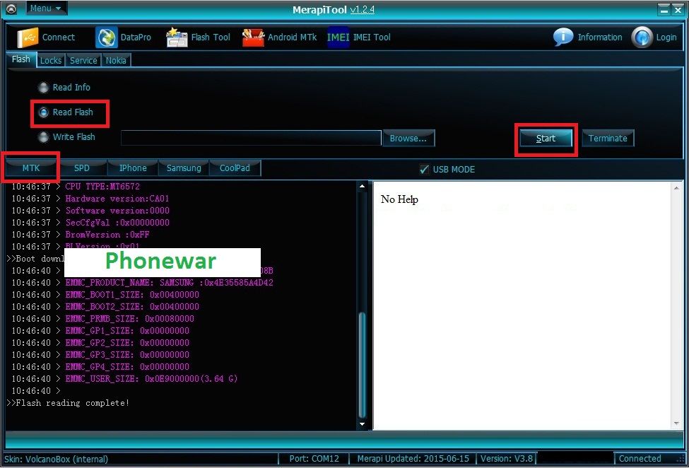

From Volcano Read .BIN
File Step by Step Tutorial
This Procedure no need to root Phone
only ADB turned on in phone
Readed flash (.BIN Format) By Volcano too or Merapi tool

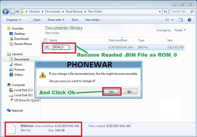

Read Flash File .Bin Format
Rename .BIN file as "ROM_0"

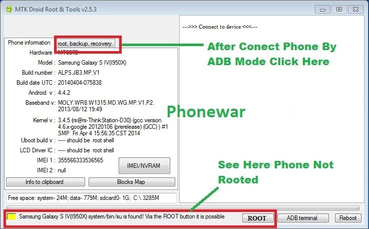

Now connect phone to MTK Droid Tool in ADB mode
And select "root,backup,recovery " in MTK Droid Tool

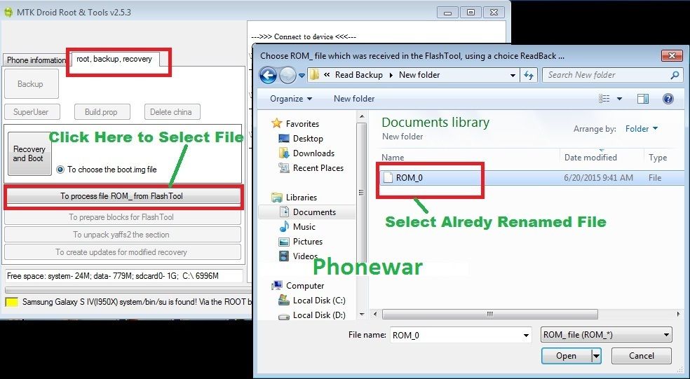

now click "to Process File Rom_ From Flash tool" and Select Already Renamed ROM_0 File

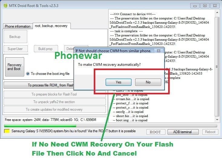

Now process will started after select file..if ask to make CWM recovery automatically
Click YES and NO process will continue (if you Need CWM recovery on yor Phone click Yes)

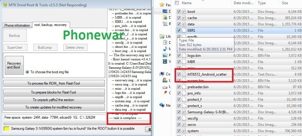

now MTK Droid tool show "Task is Complete..!!" now your Stock rom Scatter File is ready
you can find your file in MTK Droid Tool/backup

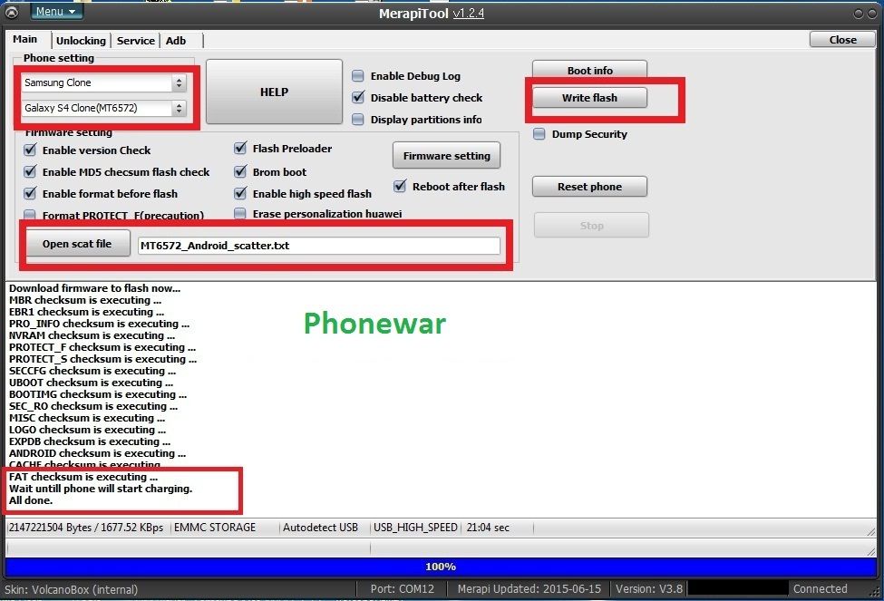

Then Flash w/ merapi or sp flash tool
in case after flash Phone hang in logo then format with merapi tool 100% working
