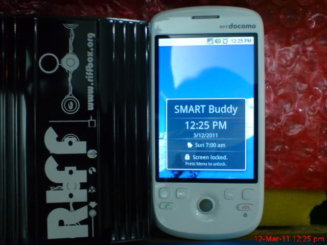

HT-03A DoCoMo, android os 1.6 unlocked by Riff box no need to downgrade to 1.5
unlocking procedure given na po lahat sa program ng riff box
Open serial port...OK
Connecting to the RIFF Box...OK
Firmware Version: 1.18, JTAG Manager Version: 1.26
Selected Resurrector: [HTC Magic 32B]
Connecting to the dead body...OK
Detected dead body ID: 0xA01700E1 - CORRECT!
Set I/O Voltage reads as 2.60V, TCK Frequency is RTCK
Adaptive Clocking RTCK Sampling is: [Sample at MAX]
Resurrection sequence started.
Establish communication with the phone...OK
Initializing internal hardware configuration...OK
Uploading resurrector data into memory...OK
Starting communication with resurrector...OK
Detected an Initialized FLASH1 Chip ID: 0x00AD/0x55BC (512MB)
Selected Unlocking Data for the NAND Chip with Page size = 2KB
Unlocking the Phone...OK
Unlock complete!
