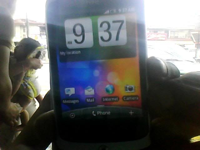

Procedure: >:D<
Step 1, With The HTC Wildfire Turned Off
Step 2, Press And Hold The Volume Down Button And The Briefly The Power Button
Step3, Wait For The Screen With Thw 3 Android Amages To Appear And Then Release Volume Down Button
Step 4, Press Volume Down To Select Clear Storage And Press Soft Power
Step 5, Press Volume Up to Fullfactory Reset
Step 6, Upter That Waiting To Restart The Phone Done

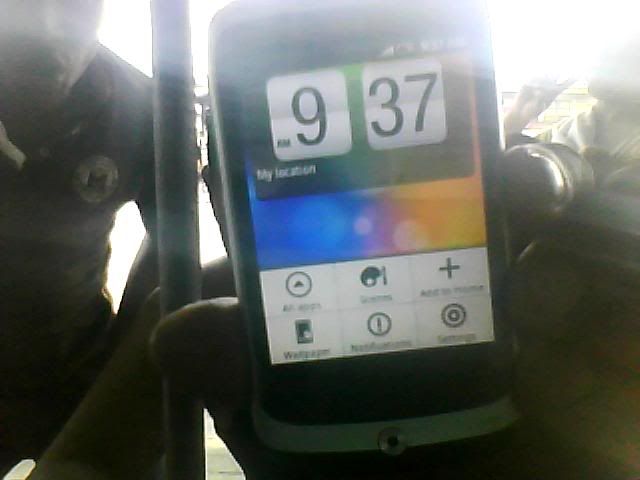

Model THC A3333
Done
singil ko po eh 450 PD na ito ;)
