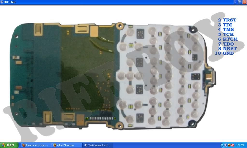

share kulang 1st time nka unlock ang box ko.. sa wakas nka bwenamano rin...
kailangan tlaga buksan ang unit at e pinout...

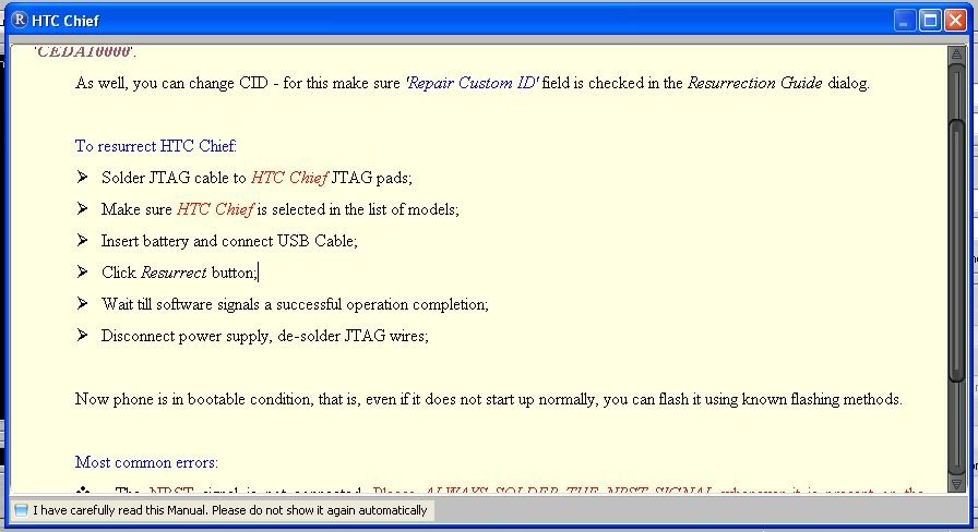

click resurrections. may lalabas na instructions.. read carefully and do the instructions..

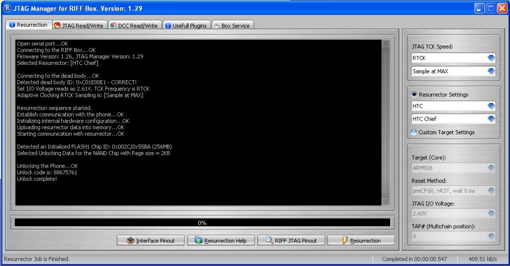

resurrect the unit 1st. if the ressurection done..
click resurrect again then select unlock..
select unlock by read codes..
logs..
