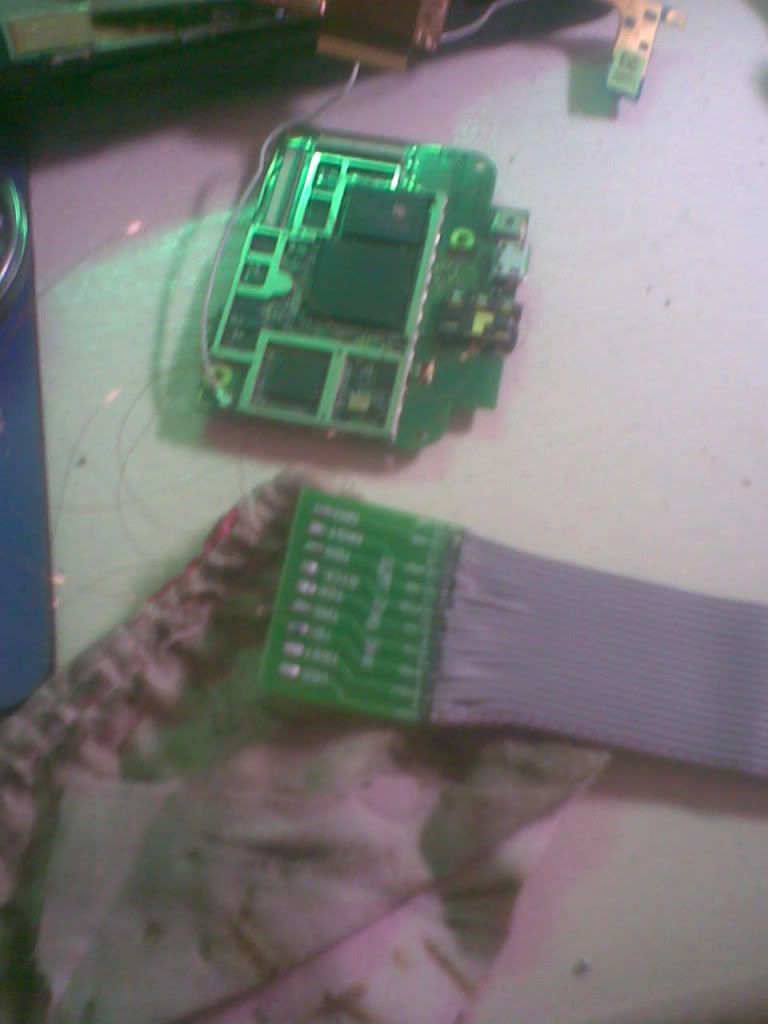

HTC HD2 pinaglalaruan ang ROM ng may-ari kaya namatay revive by RIFF JTAG..

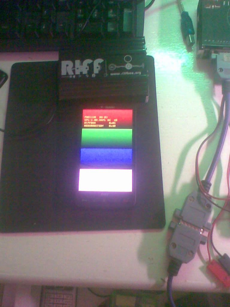

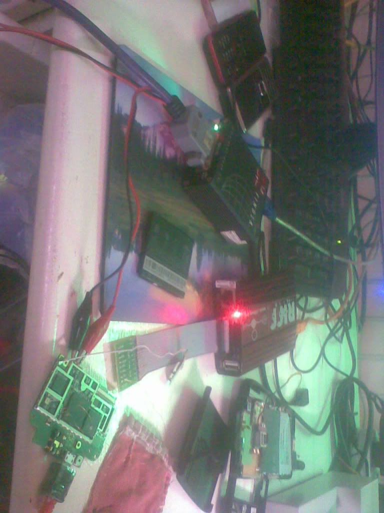

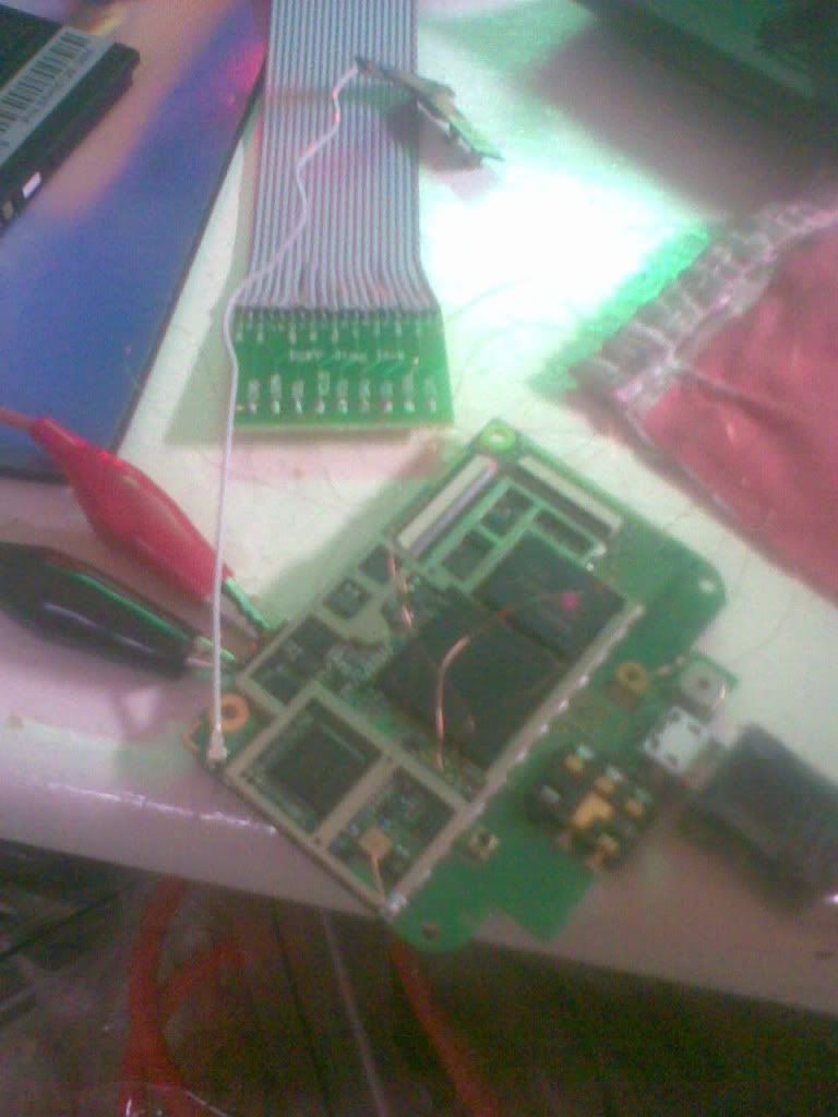

first solder all the connections given by riff pinout

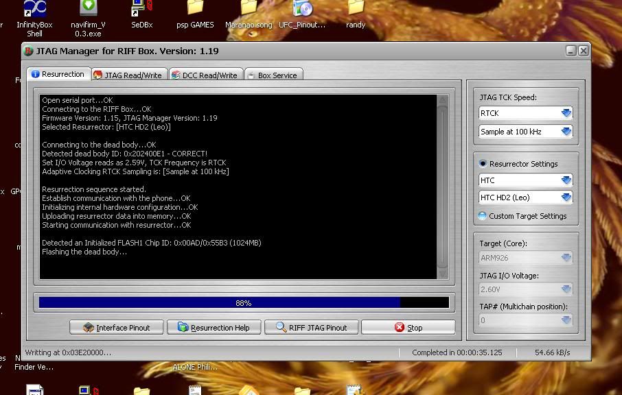

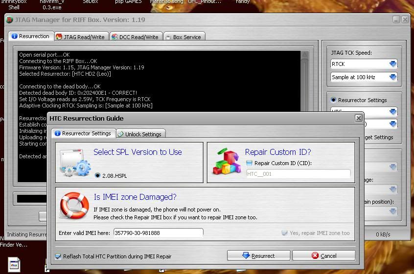

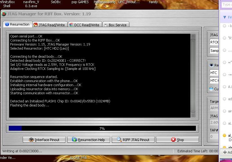

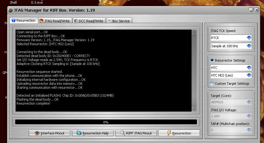

go to RIFF JTAG MANAGER.. select correct model and for me HTC HD2 LEo

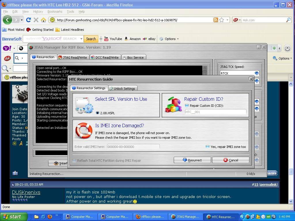

click RESURRECT button and follow instructions and set correct imei when there is a poup up a box

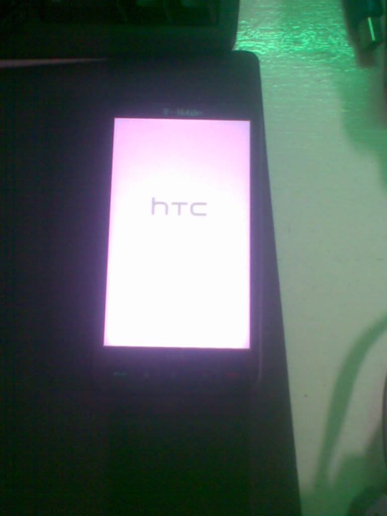

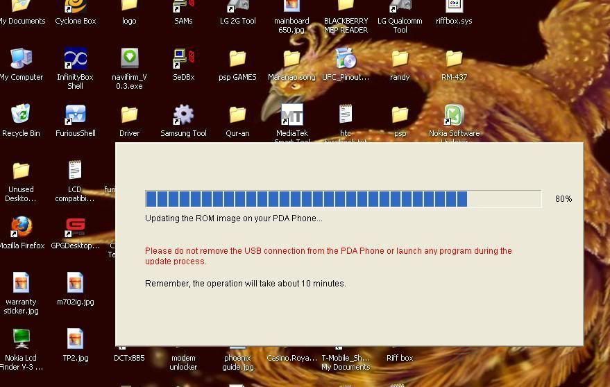

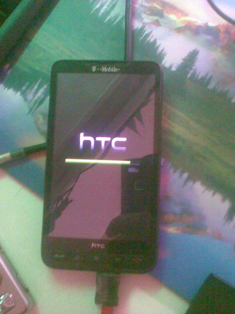

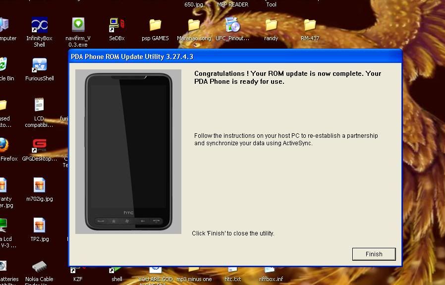

aafter resurrection finished completely...sa akin it freezes in HTC kaya flash ko or update its RUU..
at flashing PRESS down volume and PWR ON button to enter bootloader mode and follow instructions given by RUU
ganito hitsura bootloader

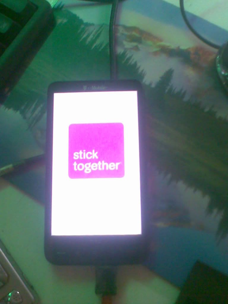

updating done..

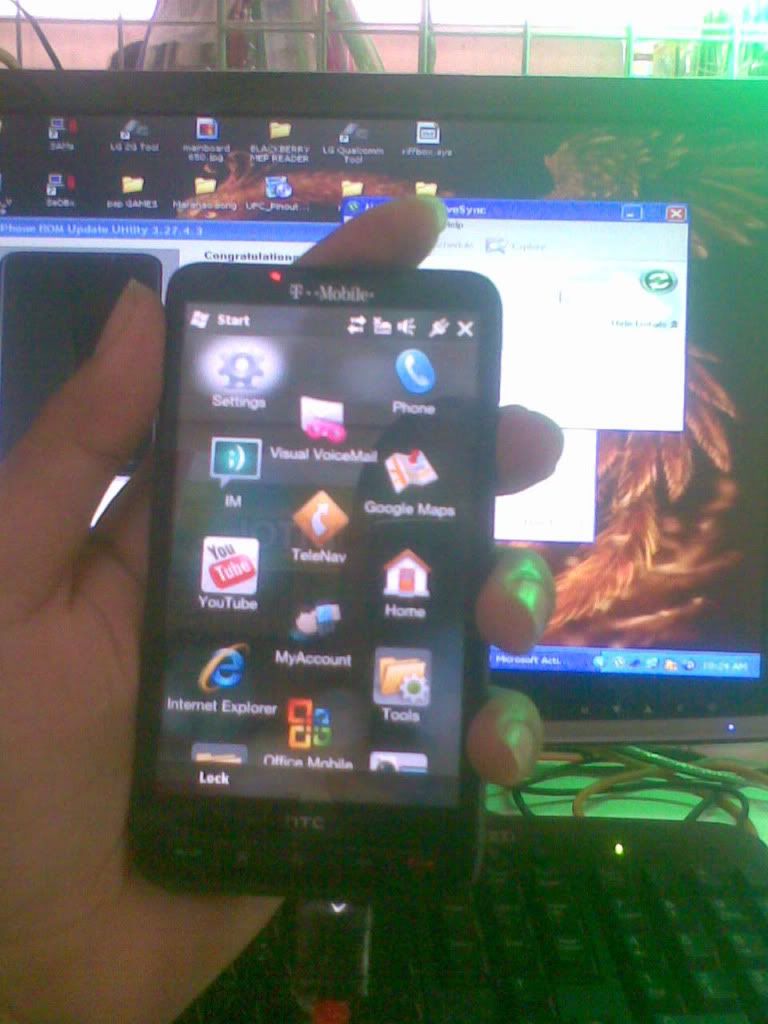

viola
updating done..
viola
