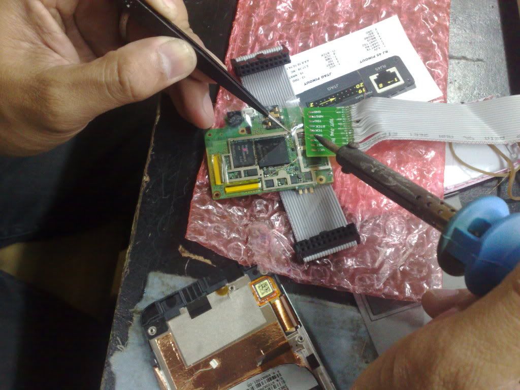

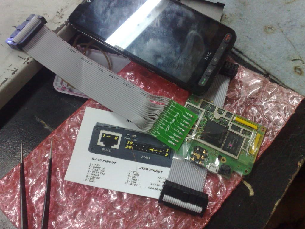

First re solder to board then connect usb connect supply then do procedure..

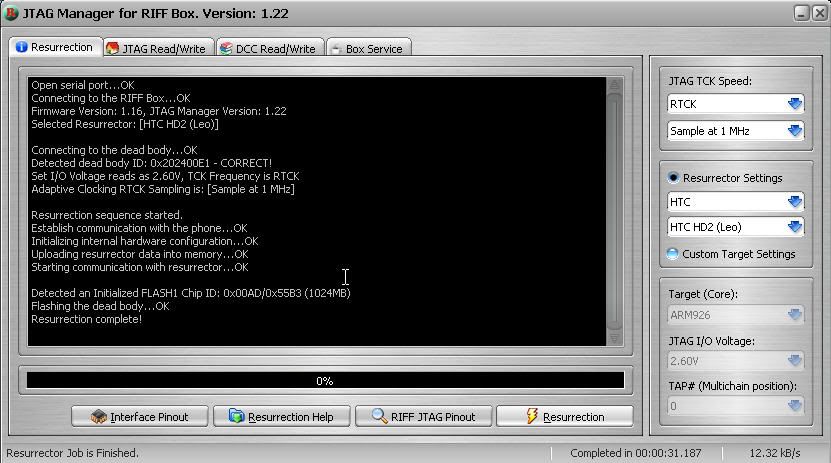

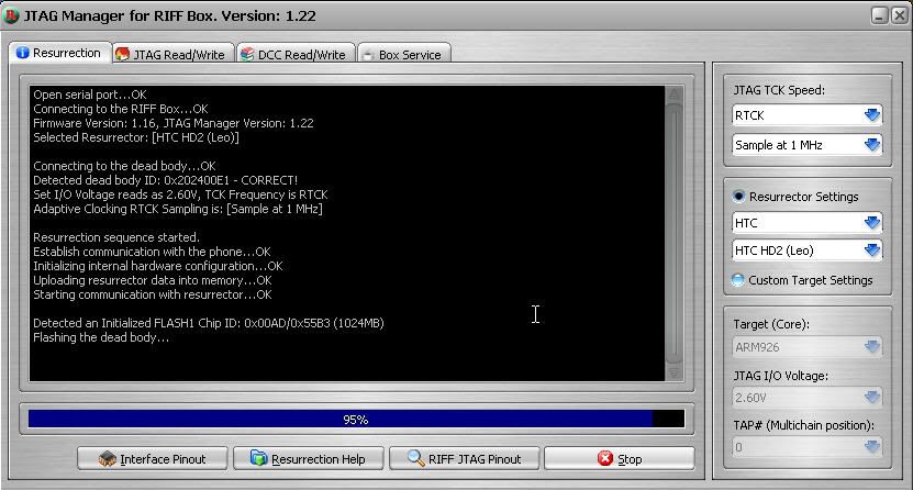

Open serial port...OK
Connecting to the RIFF Box...OK
Firmware Version: 1.16, JTAG Manager Version: 1.22
Selected Resurrector: [HTC HD2 (Leo)]
Connecting to the dead body...OK
Detected dead body ID: 0x202400E1 - CORRECT!
Set I/O Voltage reads as 2.60V, TCK Frequency is RTCK
Adaptive Clocking RTCK Sampling is: [Sample at 1 MHz]
Resurrection sequence started.
Establish communication with the phone...OK
Initializing internal hardware configuration...OK
Uploading resurrector data into memory...OK
Starting communication with resurrector...OK
Detected an Initialized FLASH1 Chip ID: 0x00AD/0x55B3 (1024MB)
Flashing the dead body...OK
Resurrection complete!
