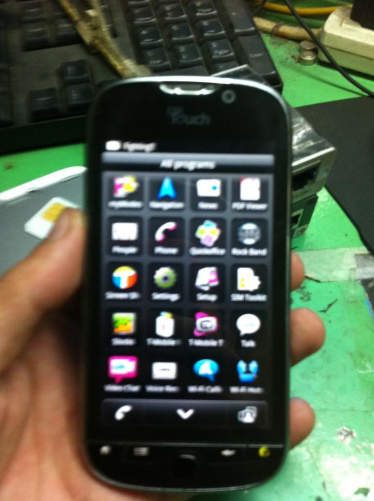

status nang unit vibrate lang.
ayaw mag bootloader
kaya j-tag na,
open unit solder j-tag pad,
click ressurect then w8 until done.
Open serial port...OK
Connecting to the RIFF Box...OK
Firmware Version: 1.34, JTAG Manager Version: 1.48
Selected Resurrector: [HTC Glacier V1.0.0.0]
Connecting to the dead body...OK
Detected dead body ID: 0x17B360E1 - CORRECT!
Set I/O Voltage reads as 1.79V, TCK Frequency is RTCK
Adaptive Clocking RTCK Sampling is: [Sample at MAX]
Resurrection sequence started.
Establish communication with the phone...OK
Initializing internal hardware configuration...OK
Uploading resurrector data into memory...OK
Starting communication with resurrector...OK
Detected an Initialized FLASH1 Chip, ID: 0x0045/0x0000 (SEM04G, 0x00008B000000 Bytes = 2.17 GB)
Detected an Initialized FLASH2 Chip, ID: 0x0045/0x0000 (SEM04G, 0x000000100000 Bytes = 1.00 MB)
Flashing the dead body...OK
Resurrection complete
