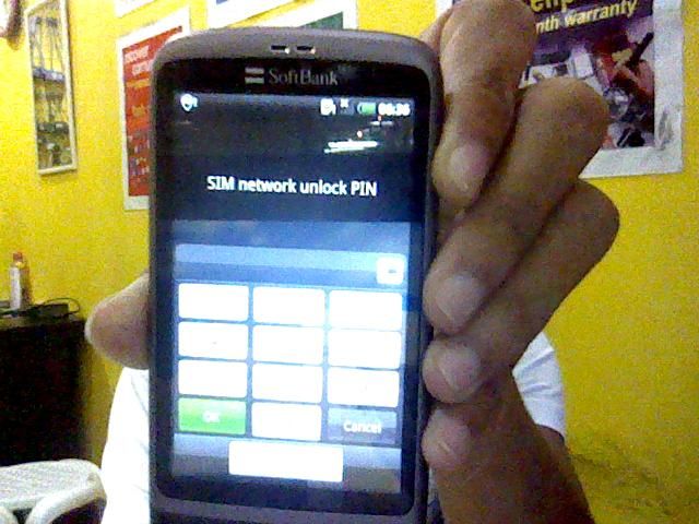

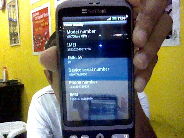

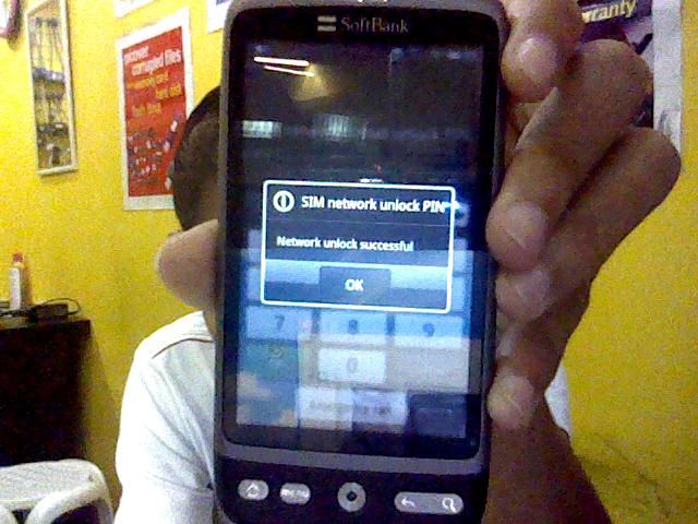

HTC X06HT PB99200 LOCCK SOFTBANK DEBRAND/UNLOCK DONE old RADIO 5.11.05.14 UPDATE TO 5.11.05.27
TOOLS
-firmware http://www.filefactory.com/file/b4a...9.00.32U_5.11.05.27_release_159811_signed.exe
-gold card ( i use lgetool for making gold card kac mas madali )
-micro usb
PROCEDURE
-insert gold card to phone
-put the phone into fastboot mode by pressing up n down volume
-now connect micro usb to phone n pc then install driver
-finally open RUU.EXE and follow instruction. wait until finest
