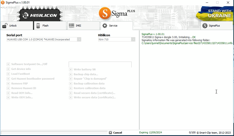

Model: Huawei Y7P- ART-L28
Problem: Huawei ID
Tools Needed: Sigma Plus,
Test Point

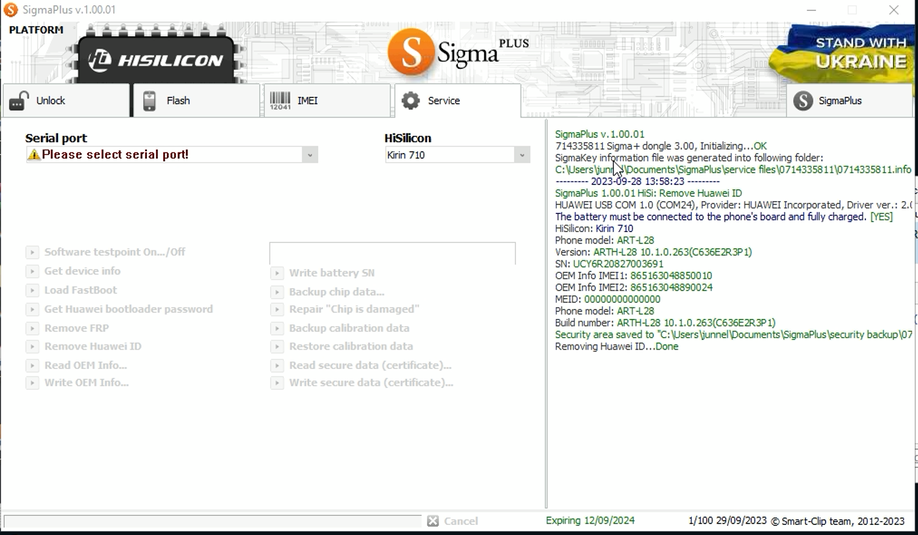

Then proceed na po step by step:
1. Select Hisilicon
2. Select Service
3. Select Hisilicon 710
4. Select go to Serial port Huawei 1.0
5. Click Remove Huawei ID
