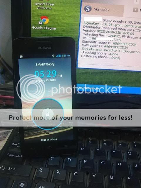

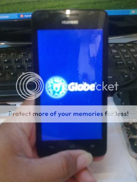

Huawei Ascend G510, Globe Lock, Unlock Done.....
Tools:
1.CA-101 usb cable
2.Sigma box
3.Drivers:http://www.4shared.com/zip/qIrH1mrw/...id_driver.html
Procedure:

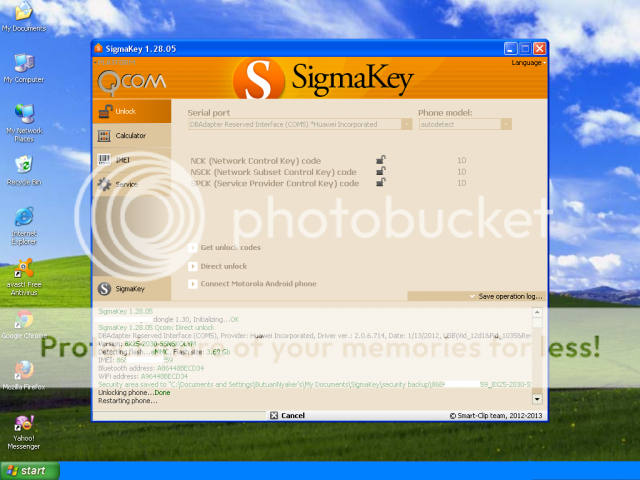

1.Run sigma key
2.Select Qualcomm
3.Set phone into download mode by pressing Power button + Vol down
4.Connect phone to pc & install driver if neccesary needed
5.Select DBAdapter reserved interface in the port selestion tab
6.Click Direct unlock
Wait until done...& smile dahil sure pera na......!
