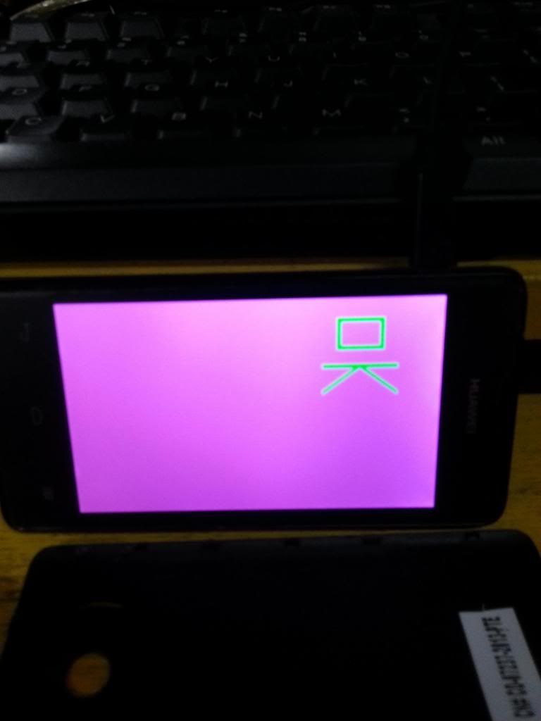

PUT PHONE IN DOWNLOAD MODE
Switch the device OFF
Remove the flash card from the phone
Press and hold down Vol -, Vol + buttons simultaneously, then press and hold Power until your phone completely freezes on the pink screen
When the phone is in "Download mode" you need to connect it to computer and install required
driver (only if the phone is connected for the first time).

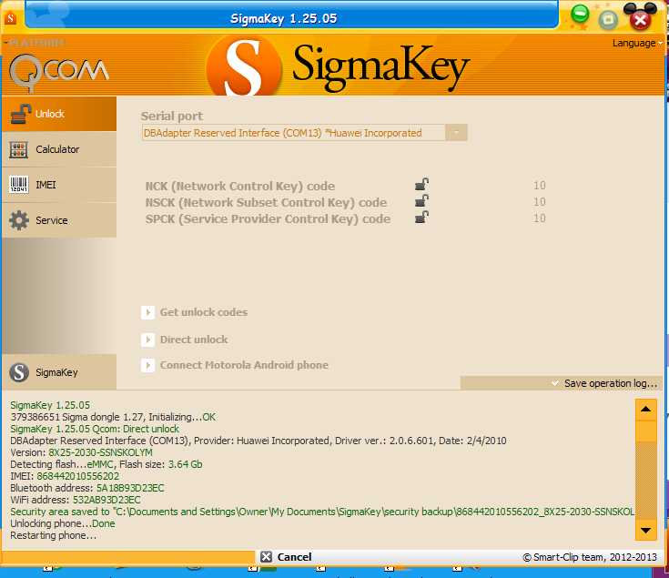

SELECT CORRECT SERIAL PORT
CLICK DIRECT UNLOCK WAIT UNTIL FINISH
