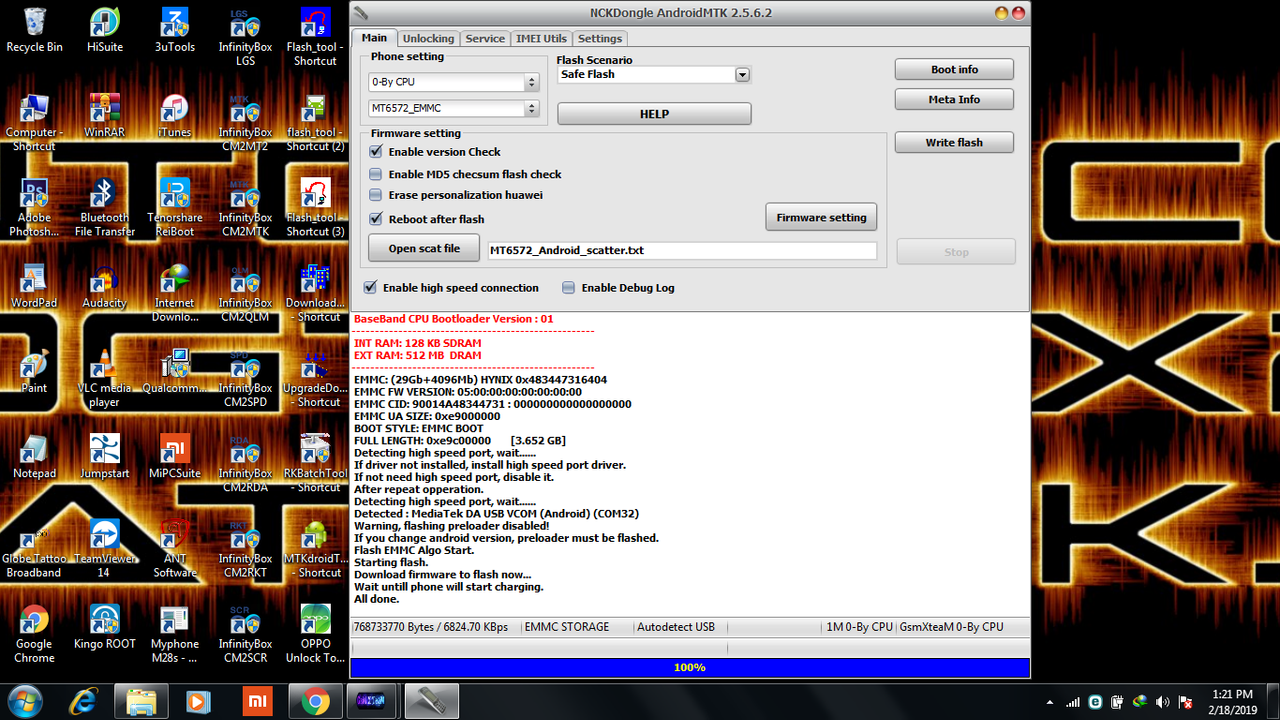

Unit Model:
Huawei Ascend Y600 (Y600-U20)
History:
Naglalaro lang daw tapos nalowbat at yun di na nabuhay and then vibrate only na lang sya.
Procedure:
Huawei Ascend Y600 (Y600-U20) Firmware
credit sa file at thread ni jaestine
-Open CM2MTK and select the 2nd option under CPU/Flatform/Workmode.
1. Click the Flash Tab.
2. Tick sa tapat ng Scatter Under Bin [IFF | Fullflash] and select the file.
3. Hit Flash Button and connect the phone, Wait until finish flashing.
Finished Product Buhay Na Ang Unit!

Mod, ChunChun salamat po sa thread tested po yung firmware tnx po :):):):):):):)
BaseBand CPU Secure Version : FF
BaseBand CPU Bootloader Version : 01
INT RAM: 128 KB SDRAM
EXT RAM: 512 MB DRAM
EMMC: (29Gb+4096Mb) HYNIX 0x483447316404
EMMC FW VERSION: 05:00:00:00:00:00:00:00
EMMC CID: 90014A48344731 : 000000000000000000
EMMC UA SIZE: 0xe9000000
BOOT STYLE: EMMC BOOT
FULL LENGTH: 0xe9c00000 [3.652 GB]
Detecting high speed port, wait......
If driver not installed, install high speed port driver.
If not need high speed port, disable it.
After repeat opperation.
Detected : MediaTek DA USB VCOM (Android) (COM32)
Warning, flashing preloader disabled!
If you change android version, preloader must be flashed.
Flash EMMC Algo Start.
Starting flash.
Download firmware to flash now...
Wait untill phone will start charging.
All done.
