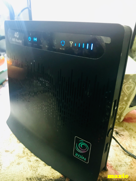

Hi

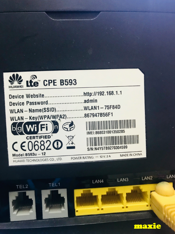

Unit: Huawei
Model: B593u-12
Software Model : Huawei EM920
Problem: Lock on Zain network Saudia Arabia
Solution: Direct Unlock via DC-Unlocker

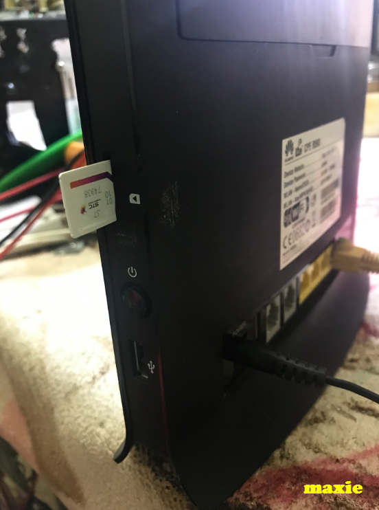

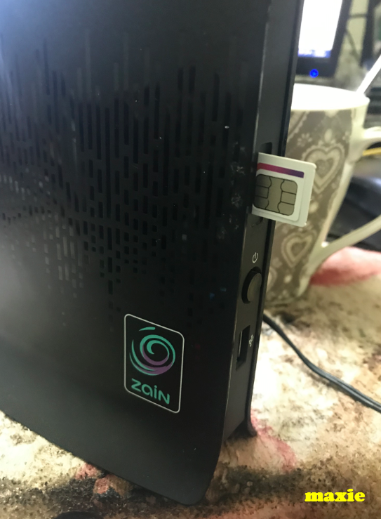

  1. Insert unsupported SIM card in router
  2. Connect B593 router to pc via LAN cable\
  3. Turn On Modem
  4. Wait for computer to recognize it
  5. Make sure router is not connected to internet

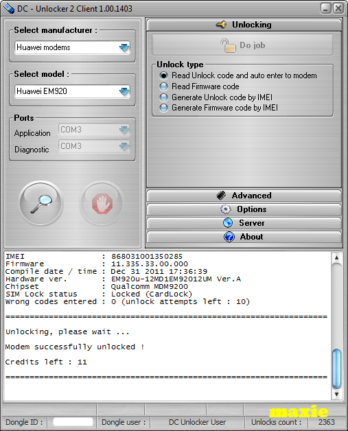

On Dc-Unlocker
  1. Open Dc-Unlocker
  2. Select B593u-12
  3. Click Seach (magnifying icon)
  4. On Unlock Tab "Tick Read Unlock Code and Auto Enter to Modem"
  5. Hit "Do Job"
  6. Done
Picture :
After Unlocked
Logs
Code:
DC - Unlocker 2 Client 1.00.1403
Detecting modem :
selection :
manufacturer - Huawei modems
model - Huawei B593
Interface           : 192.168.1.1
IMEI                : 868031001350285
Firmware            : 11.335.33.00.000
Compile date / time : Dec 31 2011 17:36:39
Hardware ver.       : EM920u-12MD1EM92012UM Ver.A
Chipset             : Qualcomm MDM9200
SIM Lock status     : [B][COLOR="Yellow"]Locked (CardLock)[/COLOR][/B]
Wrong codes entered : 0 (unlock attempts left : 10)
Unlocking, please wait ...
Modem successfully unlocked !
Credits left : 11

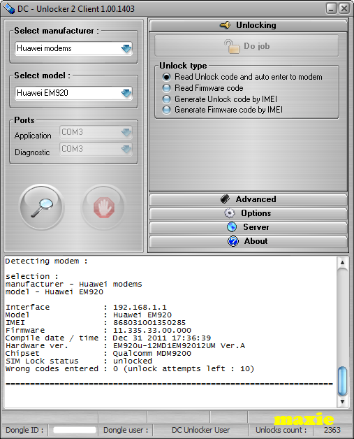

Logs after Unlocked
Code:
Detecting modem :
selection :
model - Huawei EM920
SIM Lock status     : [B][COLOR="Red"]unlocked[/COLOR][/B]
Finish
