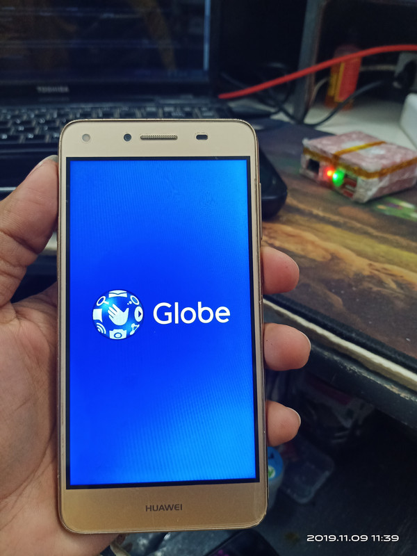

history: lock sa globe

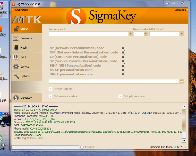

1.open sigma select MTK platform
2.off muna unit
3.hold volume up and power button then recovery mode
4.seclect reboot now pagkatapos reboot unit hold volume up again at sabay salpak USB Cable sa Unit
5.makita nyo sa port sigma(MediaTek USB VCOM (Android)Driver)select agad at direct unlock no need root passed

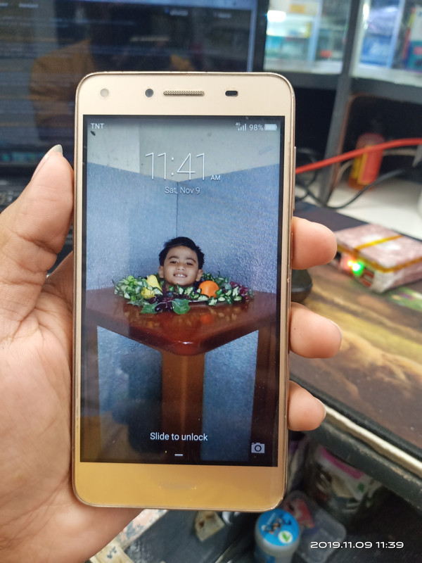

ito naman yung tapos na
sana maka tulong mga master mga lods
