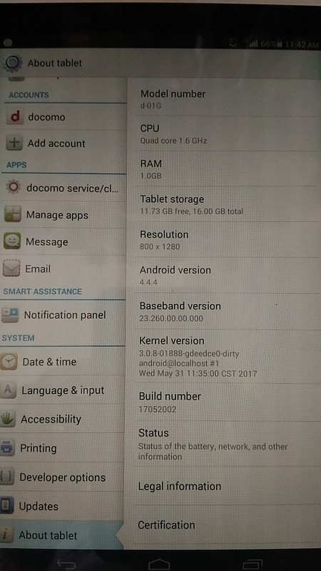

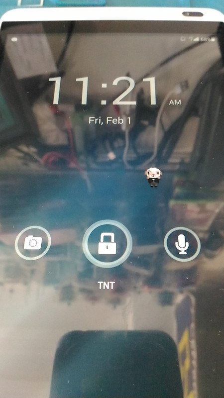

share lang po mga idol huawei dab d-01g lock sa docomo unlock sa sigma
Procedure
Huawei dtab-01G unlock done by Sigma key.

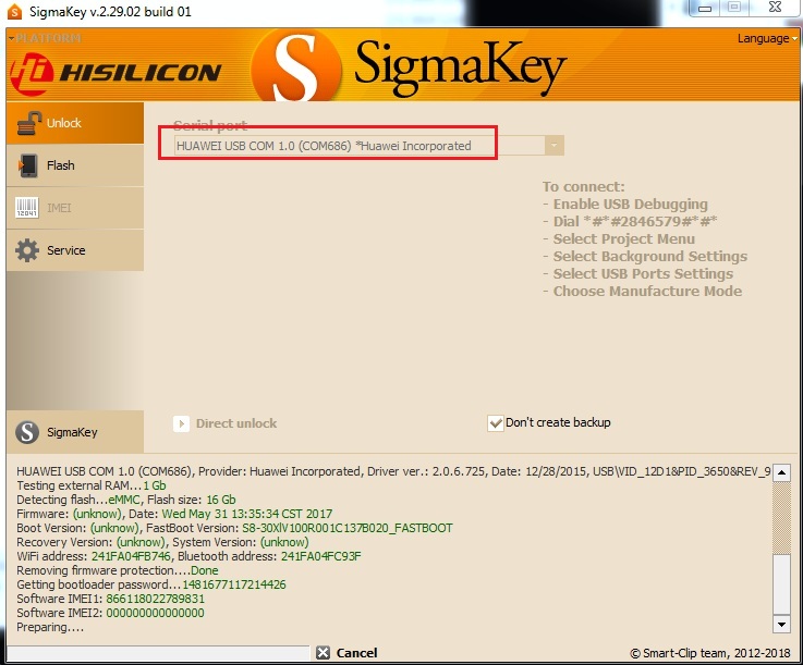

unlock procedure first go to the calculator then hold the tab in horizontal now u see a big calculator,
now type ()()2846579()()= then go to manufacture mode in usb port setting on it

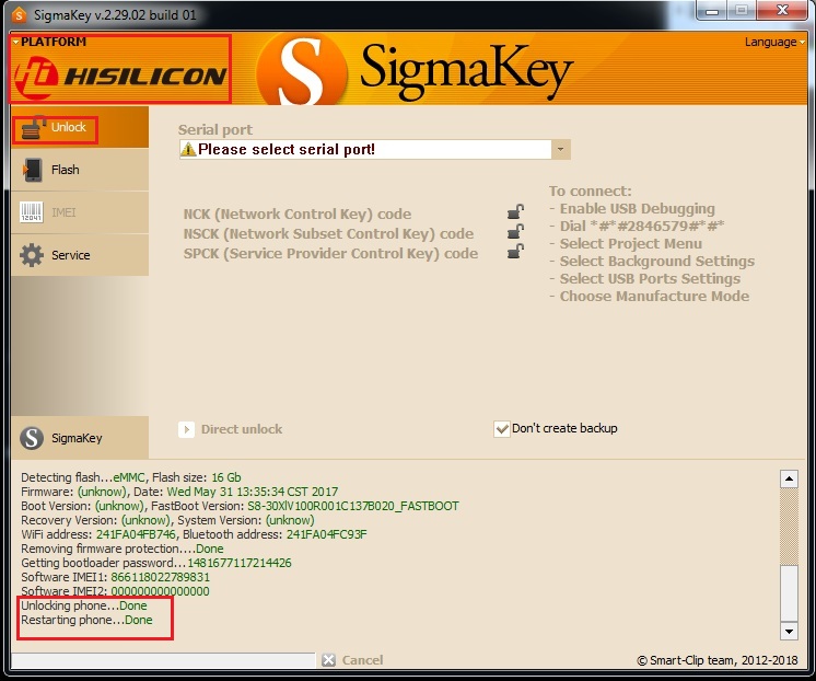

now connect the tab to the pc install required drivers then open Sigma key,select tab Hisilicon
now go to port setting and select android modem port then click on Direct unlock button & enjoy.

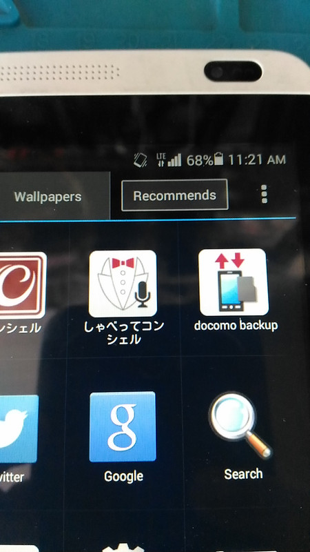

done:)
