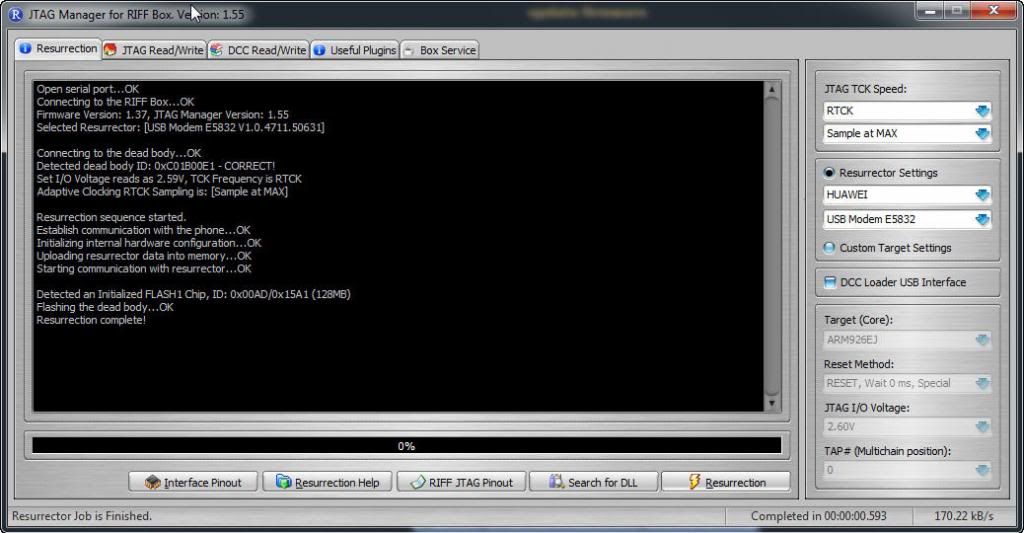

Una ko ginawa is Jtag ko Riff ok naman lahat

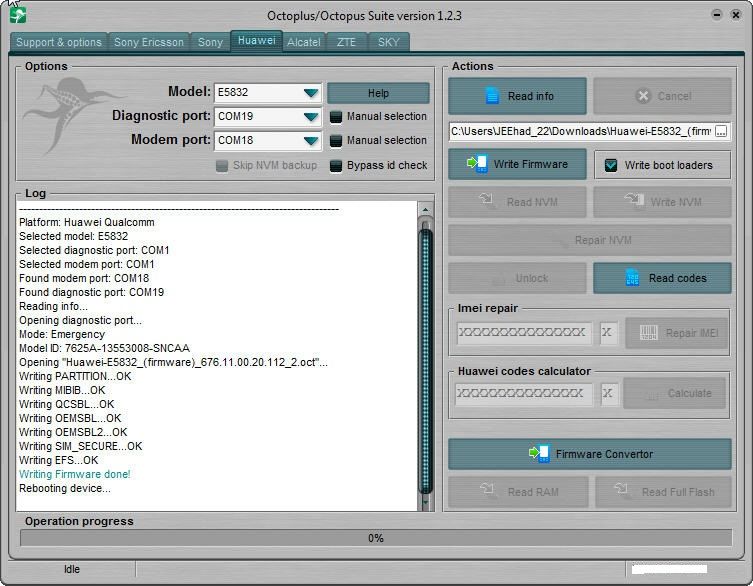

After Jtag download ako Update firmware kaso kasamaan palad lahat error dulo after error ayaw detect na pocket WIFI ilang full erase RIFF at repair boot test tatlo same parin,JTAG ulit download ako firmware sa support medusa E5832 firmware flash ko sa Octoplus Suite kaso after flash ayaw ON kahit ilaw dead boot na naman

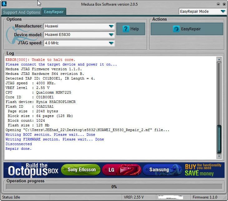

Kaya linabas ko na MEDUSA,napansin ko at nag search ako uncle google nakita ko same itsura ang E5832 at E5830 dahil sa support wala list ang E5832 tanging meron lang is E5830 at E5832S,angE5832S nakita uncle google iba screen pocket wifi na ito dun ako napatutok sa E5830 dl ko mf.file proceed Jtag using MEDUSA proceed boot repair ulit.
kagandahan after boot repair kusa fulldump pocket wifi package siya boot repair

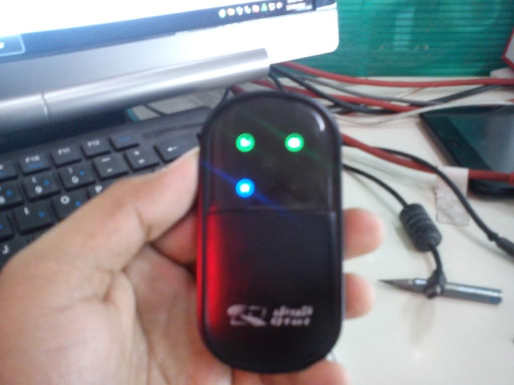

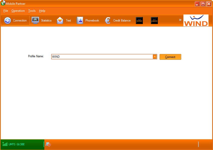

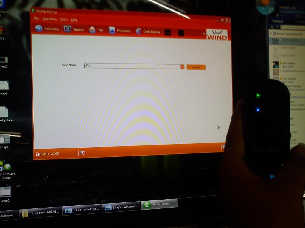

Ito na resulta Done ok na ang lahat From E5832 to E5830
Signal ok
