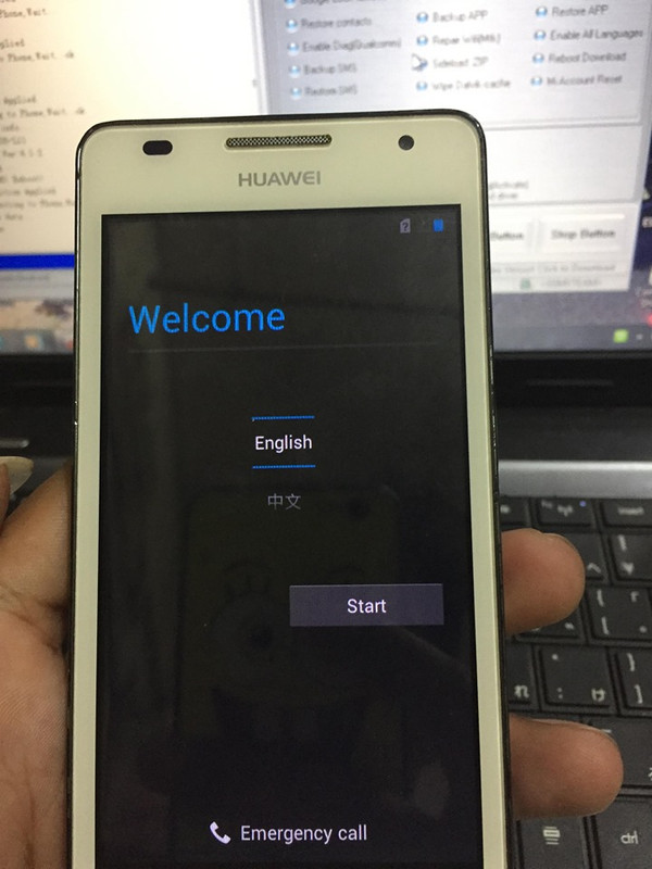

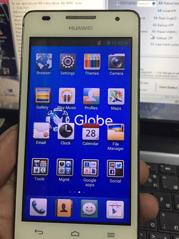

Share ko lang po... Huawei G526-L11
Problem: TMPA kaso nka lock bootloader...
action taken...
1. Unlock bootloader first kay miracle cracked 2.82...
d ko nkunan nang ss. pero unlockbootlaoder nyo lng na nka on ang unit...

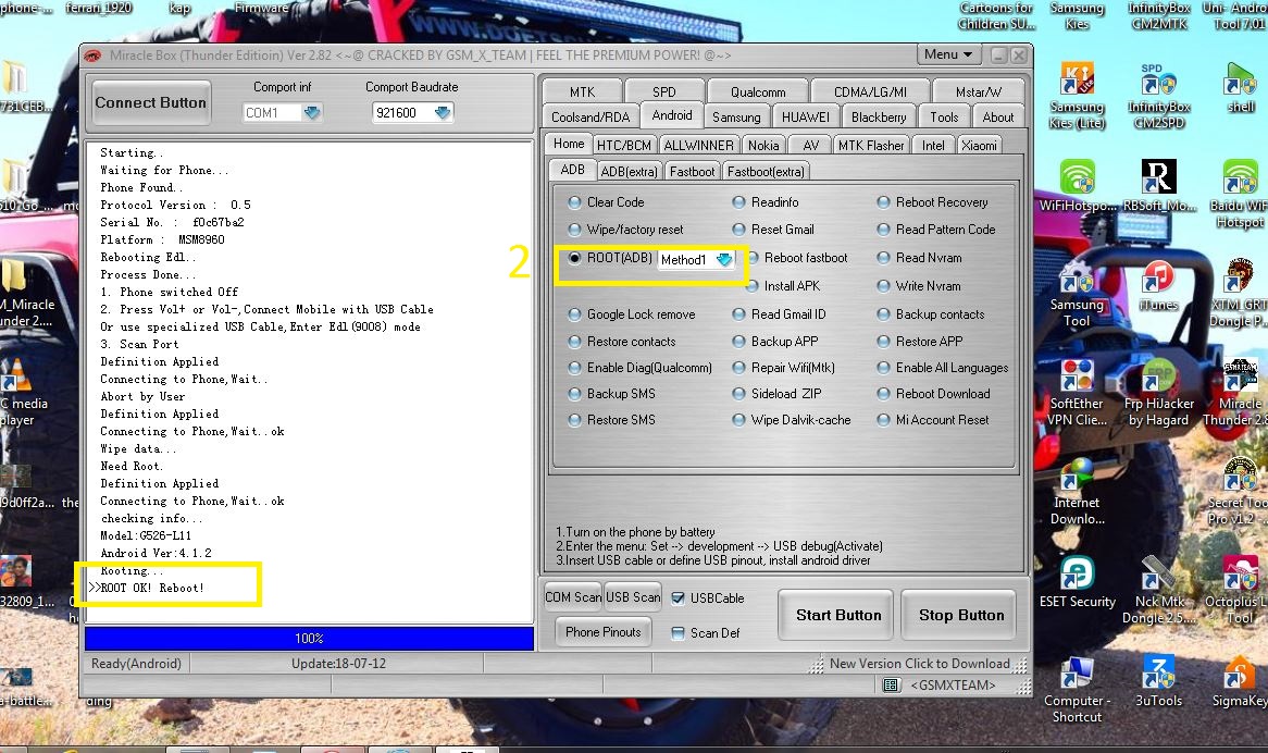

2. Root nyo ang unit...

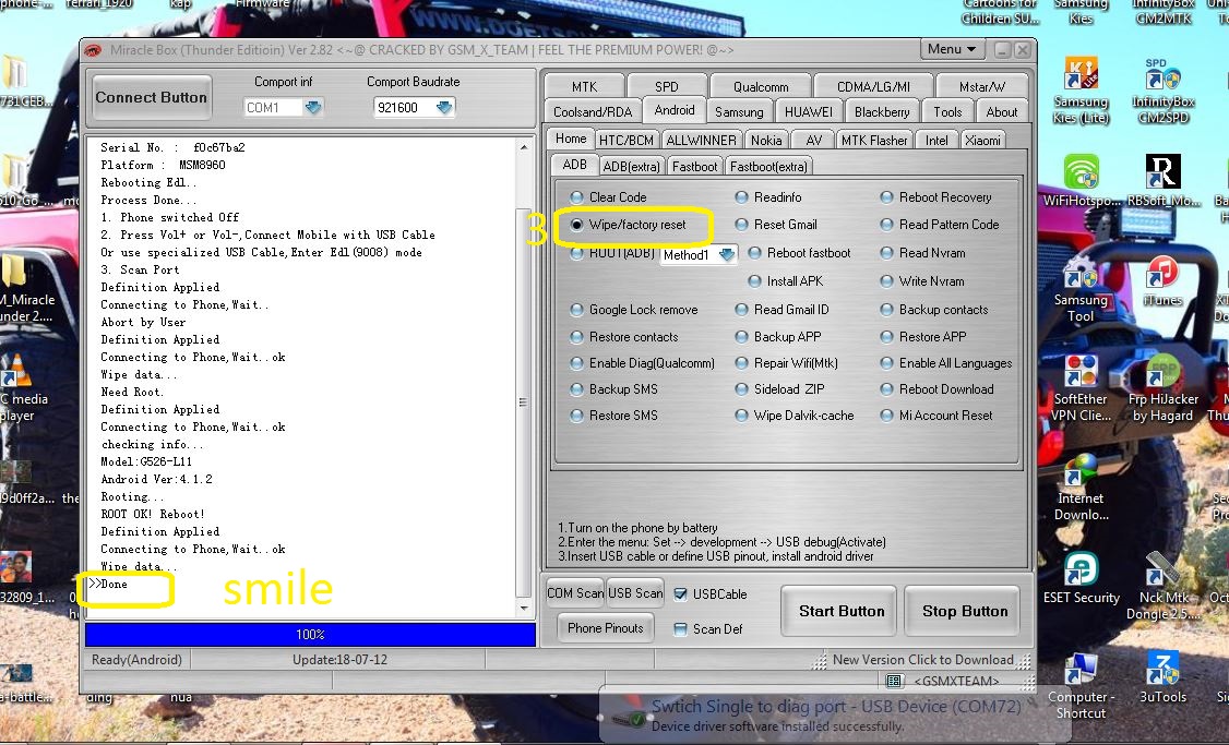

3. After root, wipe/factory reset and done...
root
wipe
sana makatulong...
