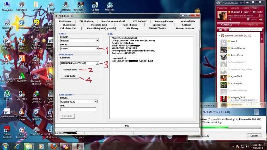

open nckbox SW/huawei phone tab
4.follow steps from 1-4
choose model
refresh port
choose mtk port no
tick read code and wait
5.lagyan ng simcard dito sa pinas at hihingi na ng np code at ienter yung lumabas na code......happy unlocking
