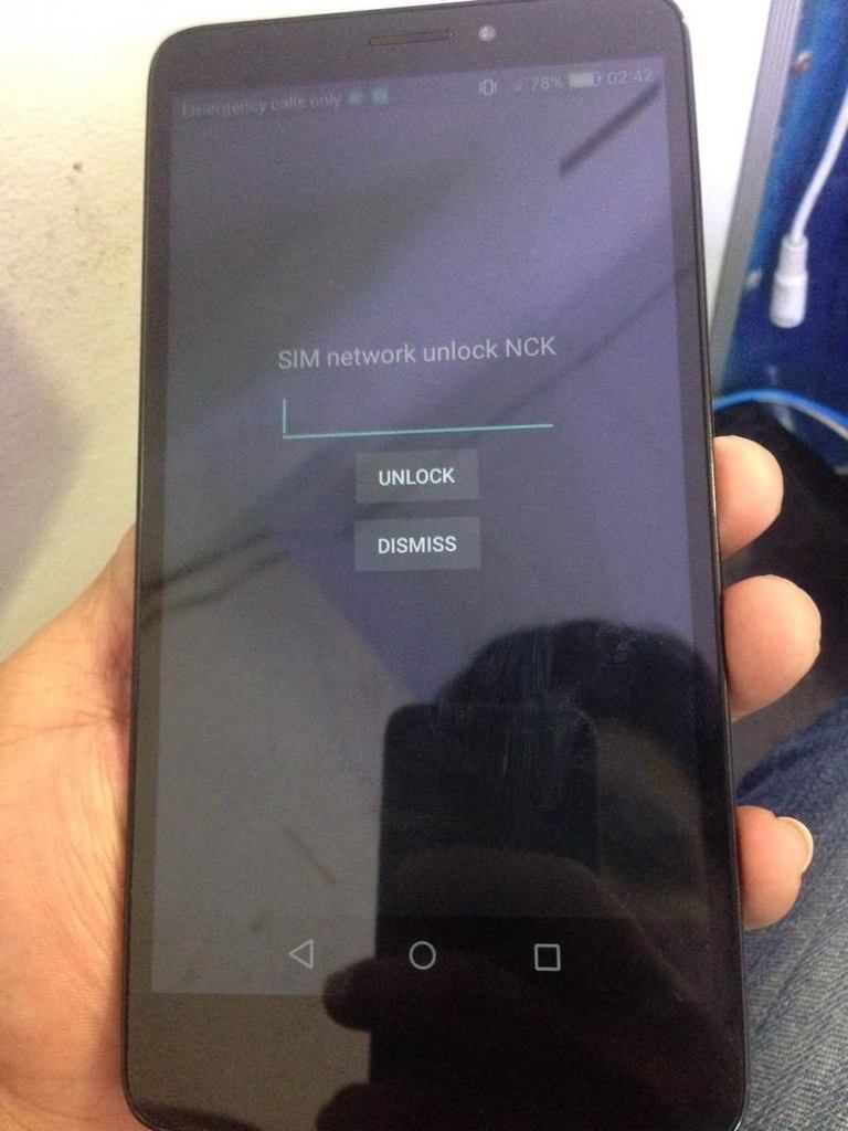

Huawei H1611 AT&T LOCKED.UNLOCKED DONE

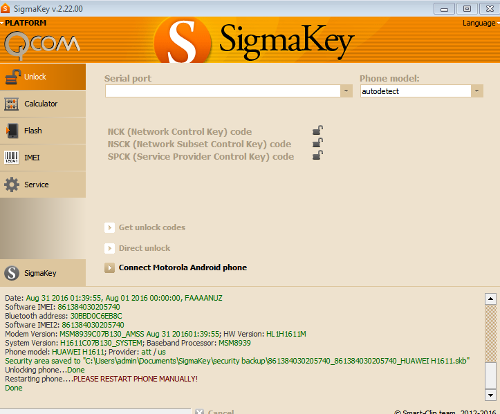

Enable Usb debugging
Enable OEM Unlock
Dial *#*#2846579#*#*
Select Project Menu
Background Settings
Select Usb Ports
Choose Manufacturer Mode
Select "DBAdapter Reserved Interface" port
Pagdetected na Hit Direct Unlock!!
FINESHED PRODUCT..:-"
Thanks boss.. 1000% tested.... Godbless boss....
Ito boss...
