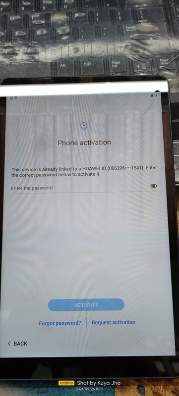

REFERENCE HUAWEI KOB2-L09 HUAWEI ID done Via HYDRA
royalcode
Feb 13, 2017
259
92
Tuguegarao City

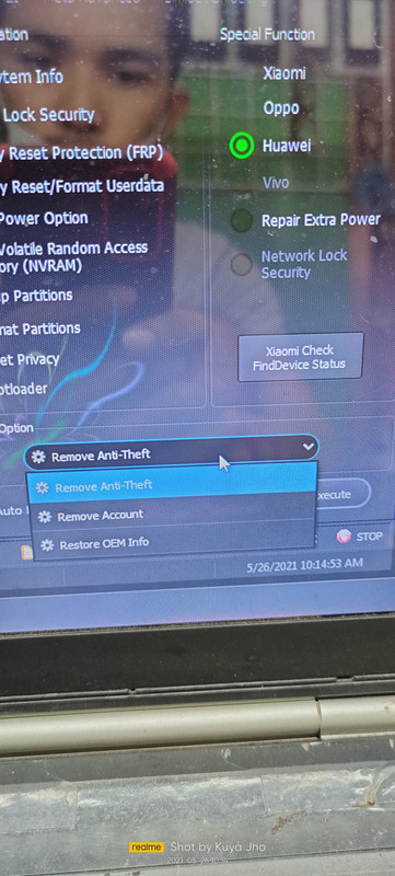

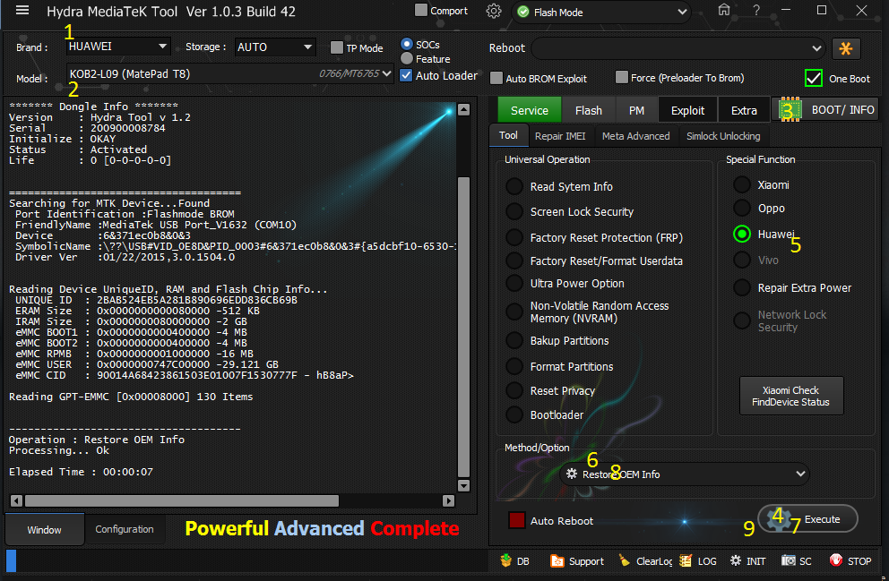

1.open hydraMTK
2.select brand
3.select model
4.boot info
5.execute
6.huawei tab
7.select remove huawei account
8.execute again
9.restore OEM INFO
10. execute again ......
11. balik lcd/tc done
DONE DONE DONE DONE DONE​
