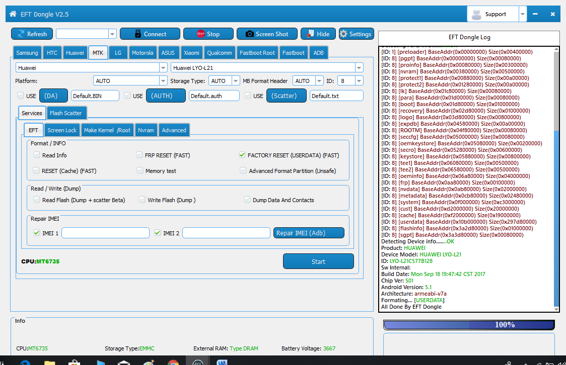

open eft dongle
click MTK
brand - select huawei
model - select LYO-L21
check FACTORY RESET(USERDATA)(FAST)
press Start
connect phone (power off) to pc
wait till done -
https://i.postimg.cc/5yn2Ns0H/lyo-l21-eft.png
- after powering on, phone in frp condition

click MTK
press Start
wait till done -
