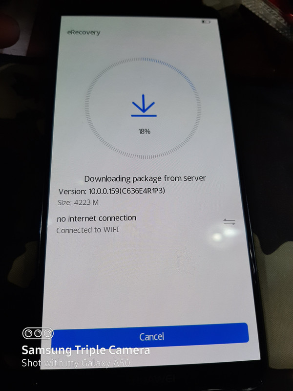

bago ako nag proceed sa steps na yan update ko muna system from version 9.1.0 tp 10.0.0
pano ko inupdate?
punta ka muna sa recovery tapos select mo download update package medyo matagal po kase malaki ang file dapat po stable net nyo
ganto po lalabas jan https://i.postimg.cc/JzTPP078/20200907-110154.jpg
https://i.postimg.cc/MZNwrZTy/20200907-112359.jpgtake note po bago gawin ang steps kailangan po ng active sim card kase need po ng internet salpak muna sim card bago mag recovery

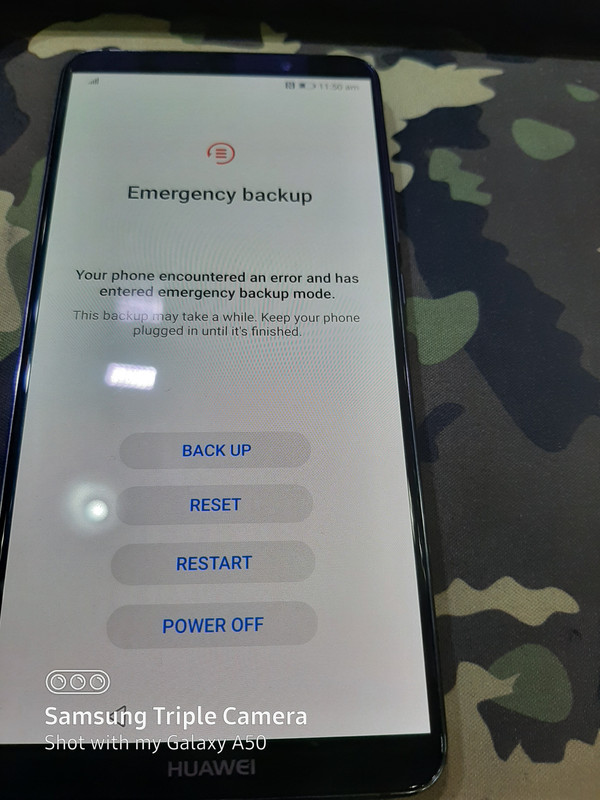

1 - boot mo muna sa recovery mode
how? press & hold vol + then salpak usb wait lang mag open unit lalabas agad ang recovery mode

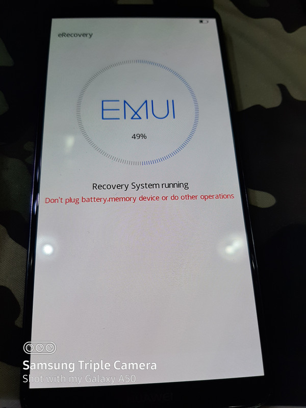

2- factory reset wait lang matapos
3- tapos tick update mode/Erecovery mode/Emergency backup/continue
mag rerestart ang unit papunta sa emergency back up
https://i.postimg.cc/RC6h0DJL/20200907-115046.jpgtick back up lalabas to

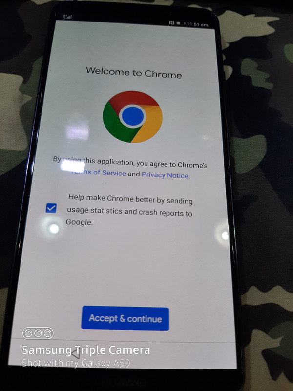

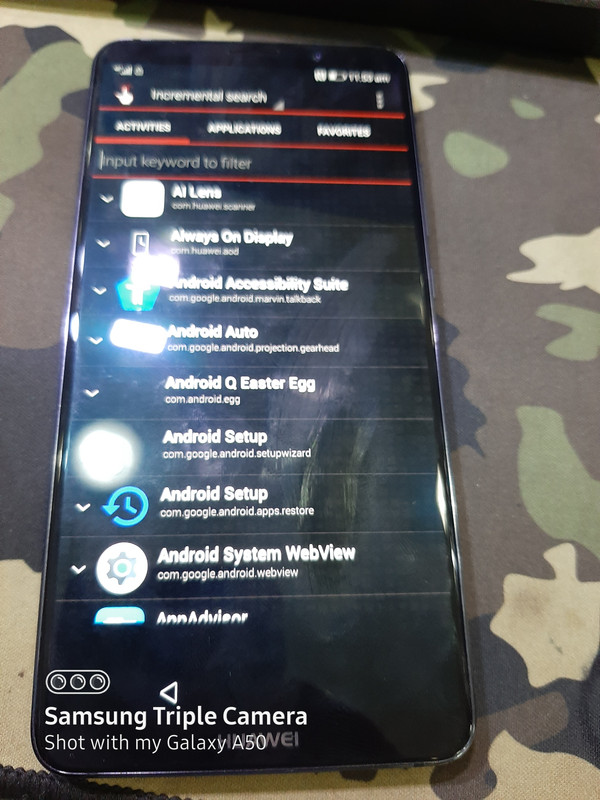

https://i.postimg.cc/tTLXP9nt/20200907-115116.jpg4 - dl muna si quick shotcut maker

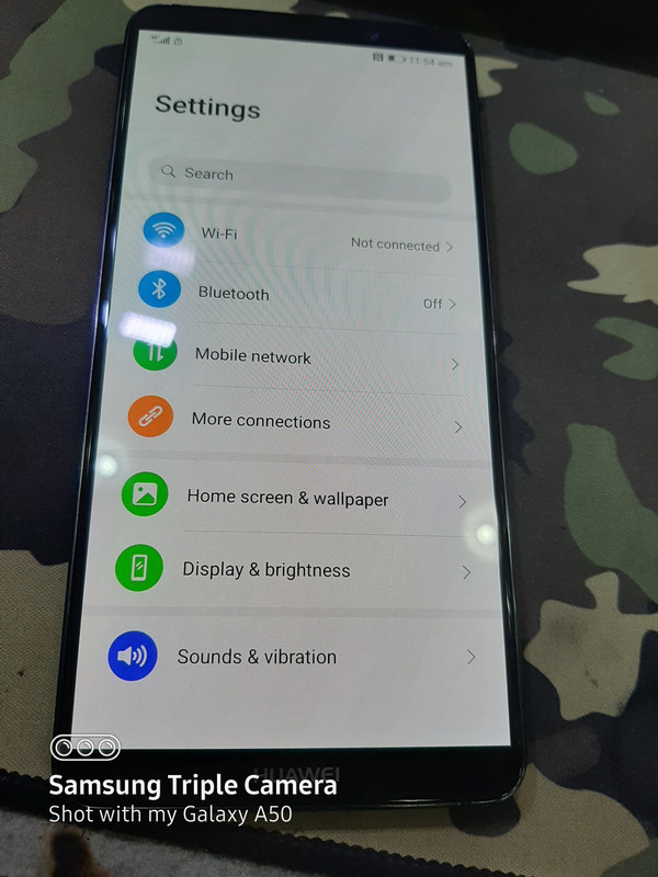

https://i.postimg.cc/25ymK147/20200907-115317.jpg5 - quick shortcut maker go to application
then hanapin si settings

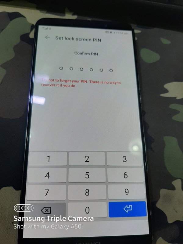

https://i.postimg.cc/Gp60gq3b/20200907-115411.jpgtick biometrics & password add ka ng password

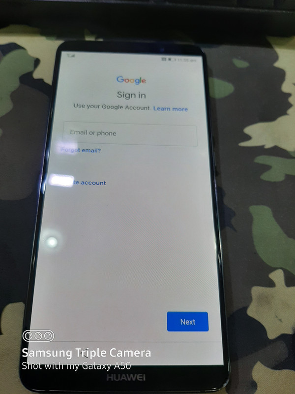

https://i.postimg.cc/JhZKmqcr/20200907-115436.jpgtapos hanapin ang accounts then add gmail acc.
https://i.postimg.cc/Y0sQQGfD/20200907-115541.jpgtapos reset sa settings system & updates/reset/rest phone
wait lang ulit matapos then setup boooooom pera na haha salamat sa pag veiw pa hit narin ng reaction button
