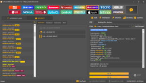

huawei mate 20 pro frp done using unlocktool
run unlocktool latest version
select huawei platform
select hisilicon kirin 980 (frp)

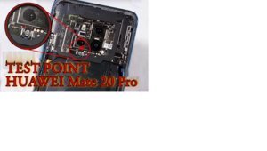

select testpoint
phone in off mode with battery, connect testpoint then connect usb cable(harmony cable) to pc
phone connected will be shown in com - usb 1.0
click (usb1.0) erase frp

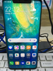

wait till operation completed
