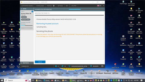

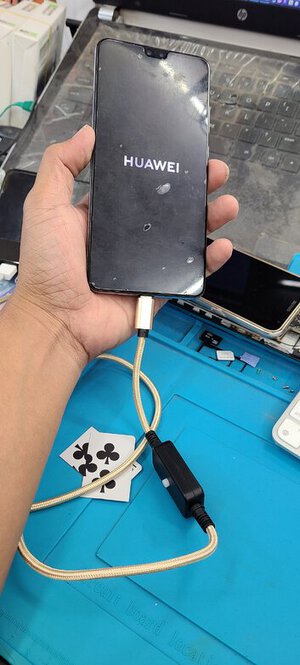

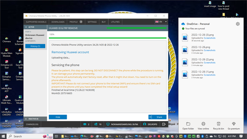

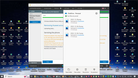

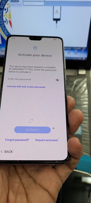

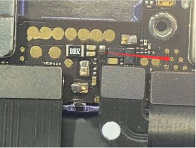

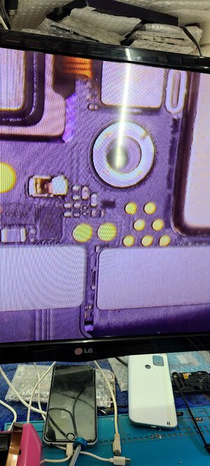

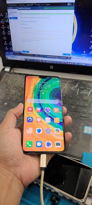

Problem: Huawei ID
Tools: Harmony TP cable and Chimera tool
Procedure:
1. Open Phone to Connect Testpoint
2. Open Chimera Software and detect Phone
3. Connect phone using harmony cable and connect testpoint, PC should detect Huawei USB 1.0
4. Follow chimera software
5. Assemble Phone
testpoint
20221226_163236.jpg20221226_163507.jpg20221226_163623.jpgTESTPOINT-MATE 30 5G TAS-AN00 test point.jpg2022-12-26 (1).png2022-12-26 (2).png
